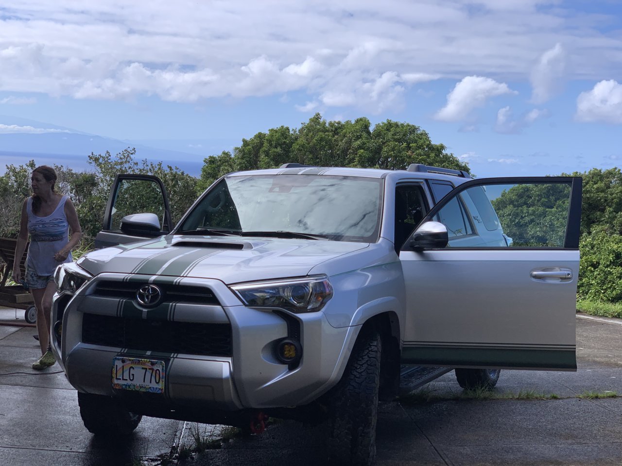

    Starr
    Starr Life Off the Road, off the Grid
    Mar 15, 2020
    #13542
    253
    Jonathan
    SouthEast Maui
    Tacoma 3rd Gen 2017 quicksand TRD OR, T4R 5th Gen TRD ORP silver , Tundra 2000 TRD OR silver, Deere 5300 4wd, Wrangler 1994 ARB air lockers, 1998 BMW R100RTL.
    KDSS, Baja Sport amber fogs, PRO Black wheels, BFG KO2's
    I'm a proponent of having easy access to a solid recovery point easily available front and rear. Yes, the red paint on the shackle is for show, but several times a year I slap a strap and another shackle on it and pull a confused tourist out of the ditch below the one-lane unpaved around the island out here. Pulling our own company vehicles hasn't happened for many a year.
