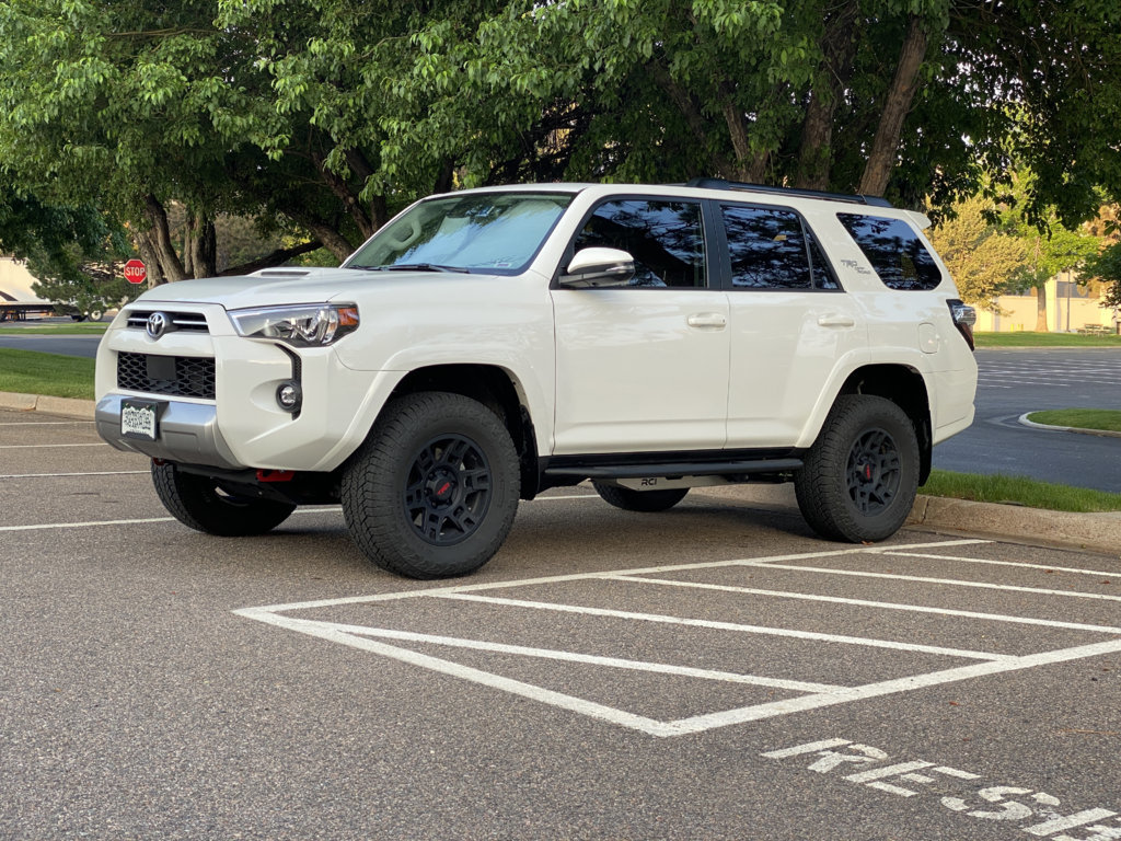

  23. Jun 10, 2025 at 7:51 PM
    Carbon Moose
    Carbon Moose [OP] New Member
    Mar 14, 2025
    #46033
    13
    2024 T4R ORP
    RCI Skids, BA Sliders
    Sending out a follow up shout out to all who contributed on this thread. Got the lift in a couple weeks ago and absolutely love it! Frankly I think a better word is nailed it! At least for my goals. Ended up going with OME 2883's up front. Somewhere along the line I got the FANTASTIC suggestion on using a slightly longer spring and leave the Eibach Pro-truck shock spring perch on the lowest setting. Much better option and gave great travel. The Eibach Pro-Lift 1" Lift spring on the back is perfect as well. A bit more robust that stock, but not so stiff that it feels like my 2500 Suburban. The whole set up gives me just a bit more than the OEM Pro lift, but still keeps it subtle/respectable enough to take clients out for lunch. Thanks everyone!
