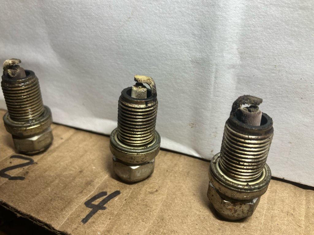

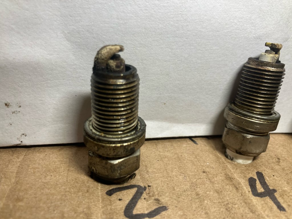

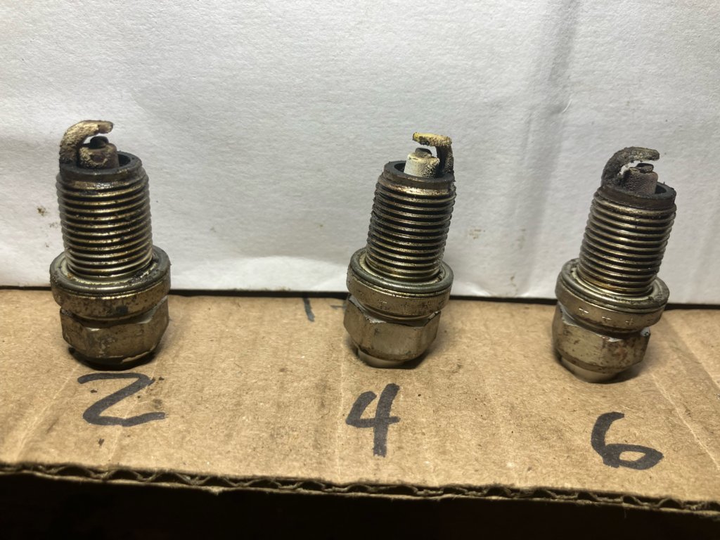

    Thanks for the responses! Daddykool, I did lubricate the hinges of the "butterfly valve" inside the volume air flow meter as suggested. It definitely operated manually much smoother post-lubrication but can't say i've noticed any performance improvements after putting some miles on it this week.
    Justthemechanic/ChessGuy - I'm ashamed to admit I can't remember the last time it got new plugs and wires, and these driver side spark plug pics sure look rough. Air filter is one of those K&N filters the previous owner installed and I've been religious about cleaning it per the vendor recommendations. I replaced the fuel filter a couple months ago.
    From what I can tell reading these plugs on cylinders 2,4,6 I have a lean condition - based on the light grey buildup? I know they are worn way beyond their service life as well. I'm learning as I go here...

  6. May 20, 2025 at 3:49 PM
    White TuRD
    White TuRD New Member
    Oct 7, 2020
    #17200
    81
    SC
    2021 TRD ORP
    Start with a tuneup and ditch the K&N filter.
    Those plugs look terrible, what is the factory service interval on those? I’d imagine 30-60k by 1994 standards
    Those ashy deposits are not normal; possibly from air filter oil. Are you using any other fuel or oil additives?
  7. May 21, 2025 at 9:43 AM
    Justthemechanic
    Justthemechanic New Member
    Dec 14, 2019
    #12325
    209
    Nevada desert
    94 4Runner SR5, 5 speed, 3.0
    OME 2” lift, BudBuilt armor, RRO sliders, Spartan rear locker
    Install new NGK BKR5EYA spark plugs, Denso or NGK spark plug wires and Denso distributor cap and rotor. The recommended change for these items is 30k miles.
    I am not a big fan of K&N type air filters but if you operate in a non dusty area it will be okay. Be sure not to over oil when you clean the filter.
  8. May 22, 2025 at 6:29 AM
    ChrisL
    ChrisL [OP] New Member
    Apr 28, 2025
    #46814
    5
    Chris
    1994 3.0 - Survived overlanding from US to tip of South America
    I'll definitely look around for a factory air filter, I had not considered the K&N oil as an engine contaminant but that makes sense.
    White TuRD - I'm not using any additives (except that K&N air filter oil, oops). I had this 4runner abroad where it was subjected to extensive mileage of dusty off road trails and even worse fuel of questionable quality would be at times the only fuel available. As a result of that, it has been on my radar to replace the fuel pump and fuel injectors (with OEM quality in mind) soon.
    Justthemechanic - My replacement spark plugs I have in hand are the NGK BKR5EYA. The existing wires & distributor cap/rotor are much better looking than those plugs but I'll replace those too. If I keep the K&N filter i'll minimize the oil and fortunately I live in a dust free area.
    I appreciate the feedback! I suppose I should have completed some of these essential tune-ups/replacements to see if this solves the post-gear shift jerking, but I had it in my amateur mind that I'm experiencing some kind of mechanical related issue and not rooted in spark/fuel delivery. I'll report back drive performance after getting these swapped out.
