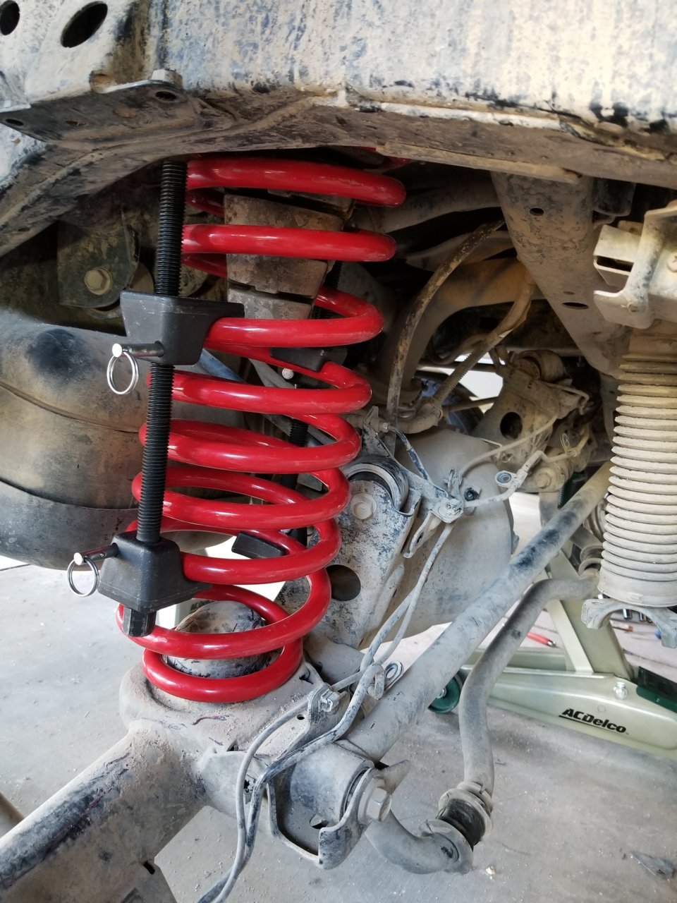

    Old vs new rear springs
    I tried using the factory jack to get the big reds in but kept coming up about 1" short20200202_141609.jpg
    Finaly got a set of spring compressors ant squished those big reds down to size.
    Then just put in the new shocks and reattached the KDSS and wheels.
