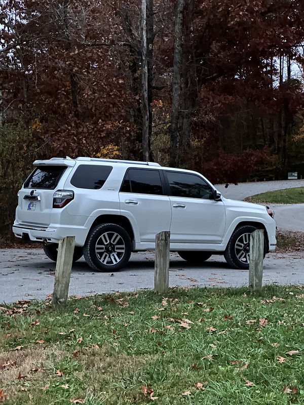

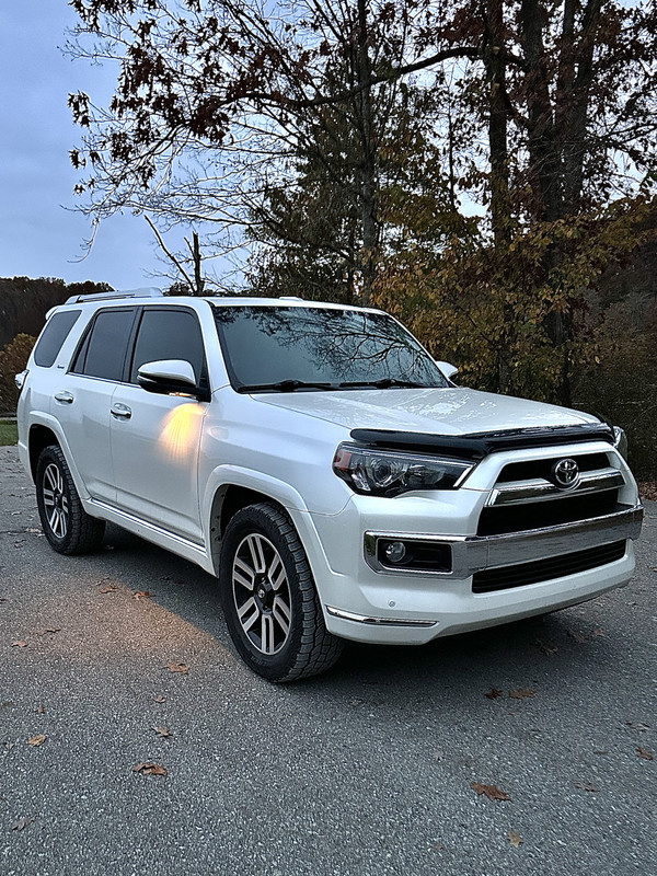

    Hi everyone, well thanks to this post I could install it on my 2014 toyota 4Runner limited 275/55R20 cooper discoverer all terrain with no rubber but I’m thinking to add 1.25” wheel spacer and I’m afraid that it could start to rubbing on it
    Also some pictures of before and after with cooper discovery all terrain tires
    Before
    After
    video too
