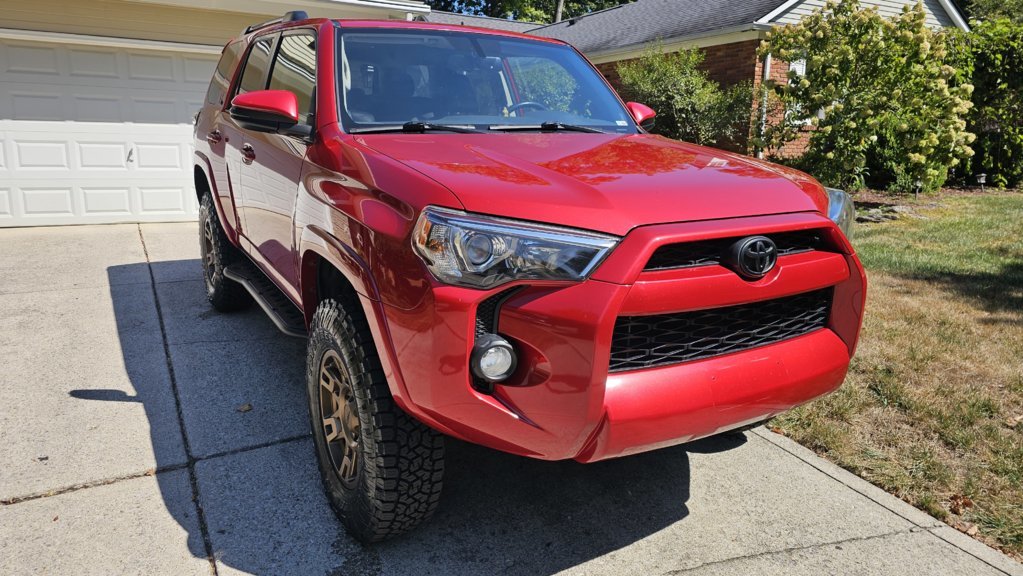

    Just installed today, no lift, no cutting, no rubbing. If I ran even trd pro wheels that poke out 10mm farther, I'd probably rub at full lock.
