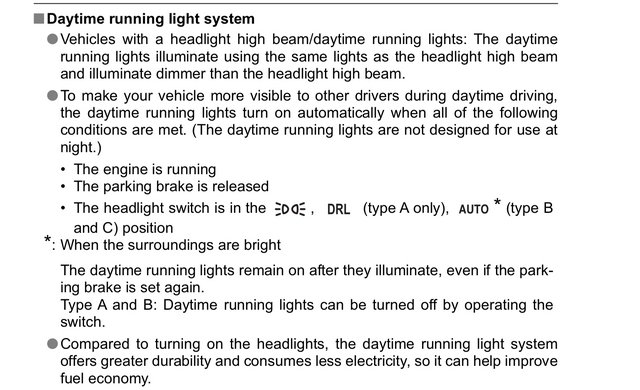

    Yea they were both in and nothing. I didn't think about the parking brake, it was on because it was the ramps while I did an oil change. If you can, please confirm they won't work wirh it on. If so, I'll order another set and try it again.
    Edit: They work, had them turned off via head unit.

    #19314
    232
    Michael
    2021 Lunar Pro
    confirmed in owners manual

    Good catch, I'll have to try again.

    Last year I had turned the DRL off through my head unit and forgot to turn it back on, they now work. Added images to my first post.
