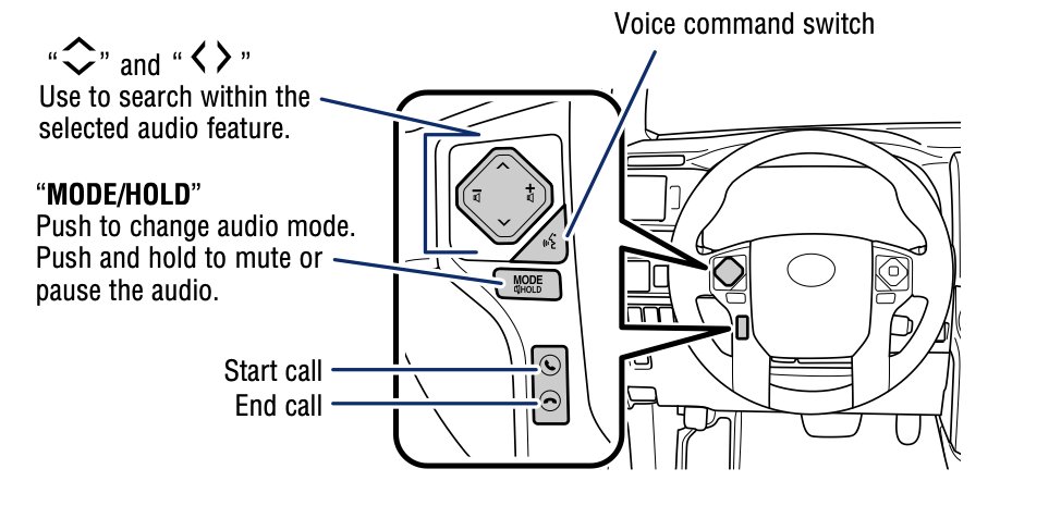

    I just remembered something about once reading of long push the 'Mode/Hold' button on the steering wheel.
