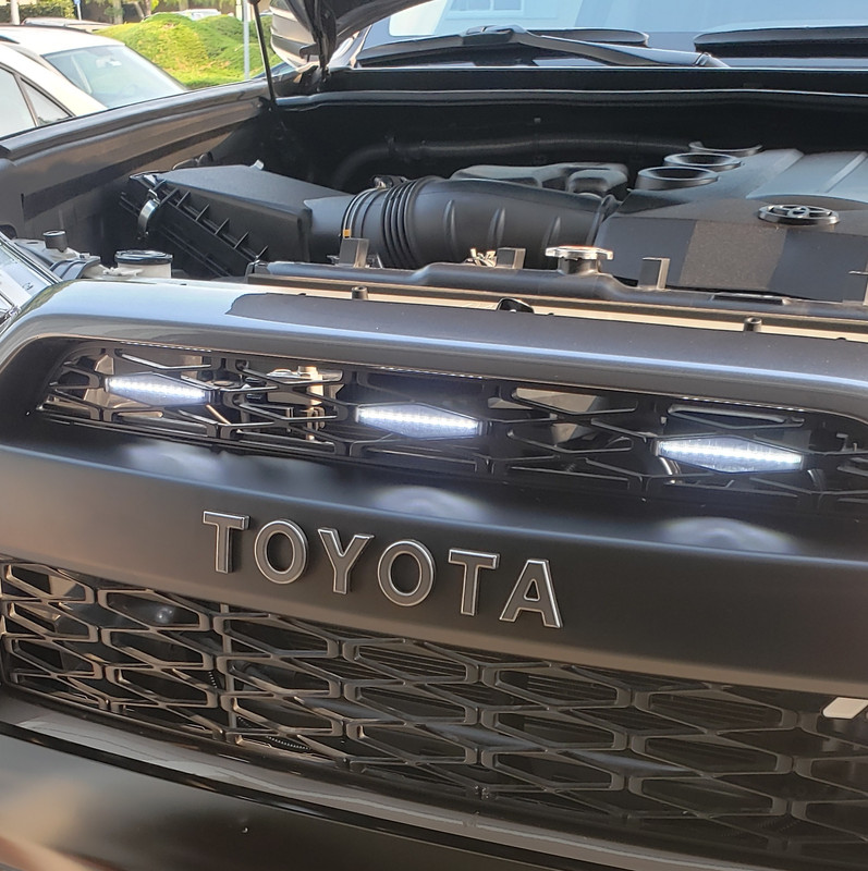

    Here's mine that I bought from running4taco.com
    Its plugged into the 10 INJ under the hood, been working well so far past month and a half.
    2020 SR5. It's always on when car is running.

    Here it is with all the lights on. It basically adds to the daytime marker lights, not for road illumination purposes. Mine are smoke gray when off.
    j4unner likes this.

    Agreed. Maybe I wasn't using the correct words. Here are mine below and I hate how you can see the 'lines' of the LEDs verses the whole assembly being lit up. Maybe the Amber ones look more 'full'? Or maybe in photos they look more 'full'?..idk. For ex, in the pic from Kfish above, his raptors look 'full' verses mine.

    If it looks full then it's just how the phone camera exposed the photo. Here's another shot properly exposed, you can see the line lol
    I think the full amber cover would give it a more full appearance. It's not a big deal to me.
