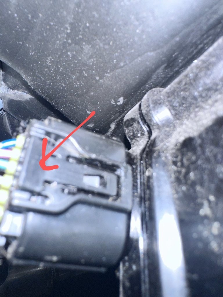

    this made me chuckle. I fortunately got it, but wow, I’m gonna be sore tomorrow from contorting myself. I also hope I didn’t zip tie it to anything important. ALSO, I’m ready to rip out my landscaping for just being a general pain in the rear. Adding pics of what it looks like pre-release in case it helps anyone else.

    Hi guys, so I ran into the same issue with getting that plug off. What worked for me was grabbing a leather work glove and that seemed to give me a little more leverage on the tab because you really need to press hard on it. But once you get pressed hard enough it does slide right off. Hope this helps.
