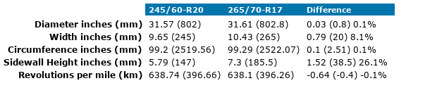

    Any tire size calculator will tell you that a 245/75/R17 is the same diameter and width as stock and would also work just fine.

    I initially thought that, and put Continental LT245/75/17s on the TRD wheels—which elicited this post:
    “Why would you go with a 245/75/17? That's a smaller tire than the 4R came with from the factory. 265/70/17 is the stock size for the 4R with a 17" wheel. Either way, it likely looks silly but will absolutely not harm anything. Just a bad tire choice and drop in economy for no reason.”
    So, I’ve been second-guessing that decision, although I’m not sure which dimension is smaller, except maybe by 0.1 inch in diameter. In that state of mind, I’ve revisited this with my dealership’s parts dept, and two tire stores, all three of whom recommend I change (Continental has an exchange trial period) to 265/70/17 (and not LT). I really grilled one tire place about the rubbing and they said they do this all the time and there’s no problem. So, I’ve been considering General Grabber AT/X (the exchange limits me to Continental or General) in size 265/70/17. Saturday, I’m going to that store and my intention is to ask them what they’d do if they were wrong and the tires rubbed in reverse at full turn. If they say they’d put my LT245/75/17s back on, then I’ll let them try it. If not, I can either stick with the Continental’s or switch to the General’s LT245/75/17, since neither has that size in a P rather than LT version.
    To be honest, if I didn’t have myself locked into Continental/General, I’d get Falken Wildpeak A/T3, which does come in a P version 245/75/17, is slightly wider, at 9.8 inches, and weighs 41 lbs, vs my current Continental’s 52 lbs.
