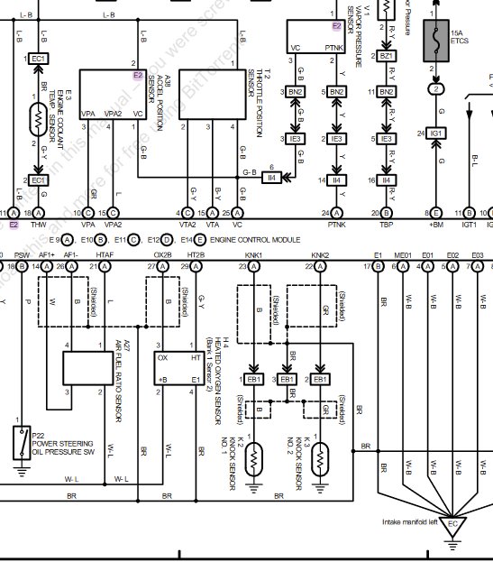

    Can you post a pic of this? I can't figure out how to see that E2 and E1 are related.
    In the diagram I have, I see E2 is connected to the 4-wire TPS and E1 is ground from the ECU. I don't see the connection between E1 and E2 though?
    I'm still learning how to read schematics. Please enlighten me?

    I turned the schematic sideways. The red tick on the TPS plug is my mark for B+, 5v. two views that show different wire colors, but the schematic is looking at the ECU connection, not the cable end. and that schematic has the 4 pin plug that Pat mentioned. The colors on my plug look different to me. also I dona' ken what the circles represent near the ecu connection on the schematic. fuse values? as soon as the gasket arrives i can wire this up and try try again.
    sri, already asked and answered,
    THANK YOU BOTH VERY MUCH, THIS IS HELPING. it's difficult when there is only one grey cell available for me to wrap it around this? signal-2022-06-18-121742.jpg

    The pic I posted was for a 2001-2002 4Runner. Prior years have a three terminal TPS and a different schematic that I don't have.
    I finally found a schematic of a 3 wire TPS, circled in red.
    You can see that E2, both in the ECU and in the TPS, is ground. It's ground for a number of things, as you can see, simply by following the Blue-Black wire around.
    It goes into the TPS plug on Pin 1. Vc comes from the ECU, and goes into pin 2. Vta goes to the ECU, and comes out pin 3.
    Looks to me like they used a voltage divider network in the TPS. With the entire voltage from the ECU dropped across the TPS, from Vc to E2. IOW, Vc, is +5 VDC, created in the ECU. It goes into the TPS, and across the resistor to E2, where it should be 0 VDC, as E2 is ground. The wiper, Vta, moves across the resistor as the throttle plate is opened and closed by the throttle pedal. It picks a voltage off the resistor, depending on where it is on the resistor, and that voltage goes to the ECU, to tell it the position of the throttle plate.
    The resistor in the TPS is known for getting dirty and corroded. It doesn't function properly then, as when it gets dirt and corrosion on it, the wiper doesn't receive the correct voltage for the actual position of the throttle place, sending inaccurate info to the ECU.
    Long rambling, but I hope it helps a little.
    Good luck to you!
    Pat☺
    standard[OP] likes this.
