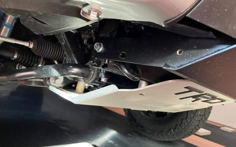

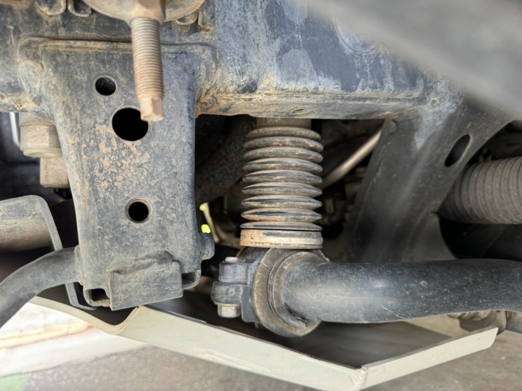

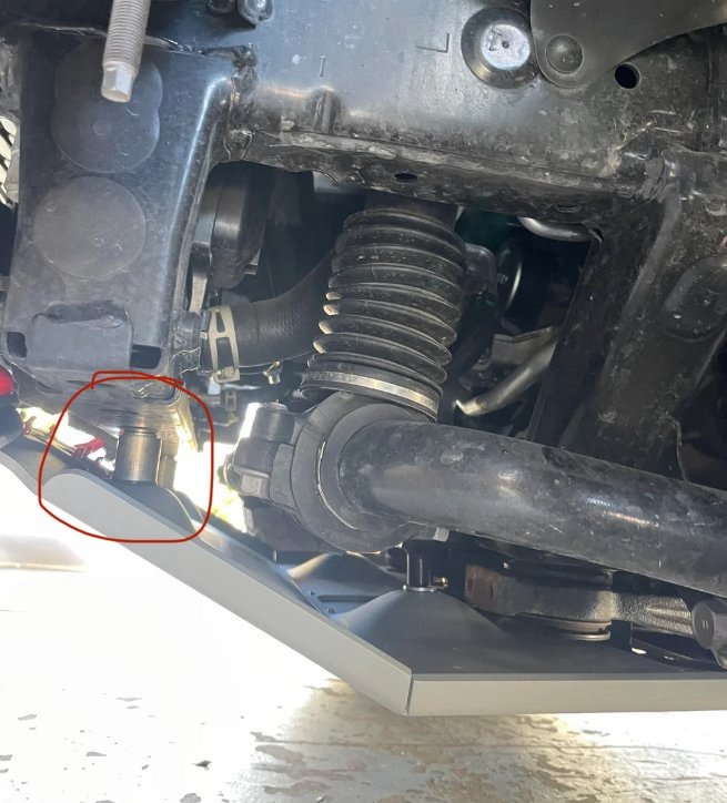

    The trd skid plate will not fit without cutting the side flanges that extend upwards in the oem plate
    The other plates sold online that say kdss only come without the flange, however it is still necessary to grind material to make it fit
    On top of that another forum member pointed out that after some off roading, he noticed that still the plate will hit the soft rubber of the kdss system - i can confirm this happens - and additional cutting out at where the kdss sway is needed for that extra clearance
