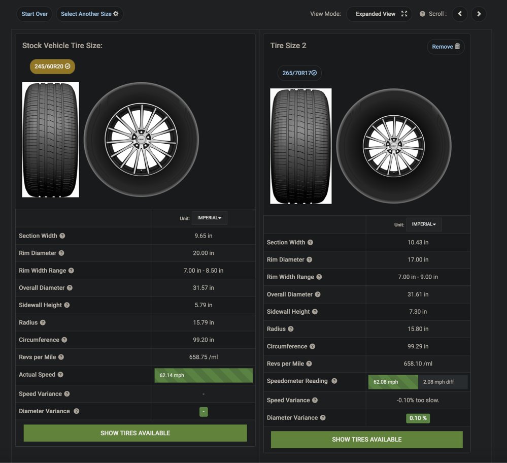

    I'm just wanting to confirm there's no compatibility issues with the ORP wheels from a 23 on a 16 Limited (my wife's).

    I really doubt if there is change to ORP wheels. These are newer 2020 TRD ORP wheels on a 2019 Limited.
    EDIT - The reason I used the word "newer 2020 TRD ORP wheels" because the older Trail wheels have a silver center vs these ones are black.

    I feel like the 265/70 17 tires should work but any evidence to the contrary? No lift on the limited.

    My only concern is the section width is almost 1" wider.

    I'm not sure about the body work interference but the suspension and brakes have been the same since 2010 so there will be no issues there.

    It's less than 1 inch wider, so I doubt this will happen, HOWEVER....that may cause some rubbing when you turn the wheel all the way right or left. But you can also trim the fender liner.
