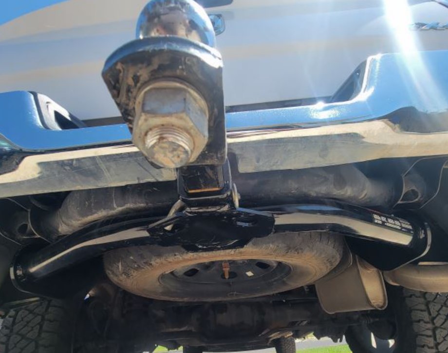

    It's all about the loads and torque applied. The "V6" hitch receiver lacks leverage against the frame, so it's not up to weight distribution hitch loads. The "V8" hitch receiver is much more beefy and can handle the greater twisting loads of a weight distribution hitch.

    "V6" Hitch, note it's got a tiny footprint and the whole member is subject to twisting by the hitch.
    "V8" Hitch receiver, note the wings that distribute twisting from the crossmember to the frame rails directly, PLUS the mount to the V6 hitch location as well.

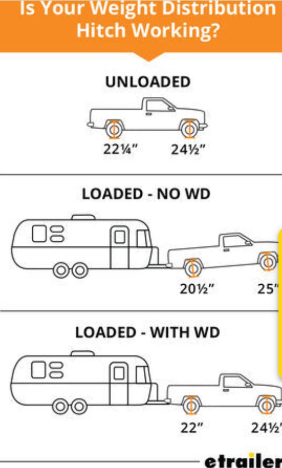

    I pull a 23' Airstream travel trailer, rated up to 6500 lbs. with my '04 V8, rated for 7,000 towing and 700 hitch capacity. Normally when you talk about the "hitch" it is both the receiver (bolted or welded to the vehicle frame or bumper) and the hitch with ball. I have always heard the first one called a "frame" hitch, the second a "bumper" hitch. Bumper hitches (which may be bolted or welded to the cross member also) place all of the trailer's tongue weight on the rear of the vehicle. A frame hitch will distribute some of the weight to the back portion of the vehicle's suspension as well as the rear but not the front axle. It does provide a more secure connection because (typically) it's bolted/welded to 4 points on the vehicle.
    I use an Equalizer weight distributing (WD) hitch, that inserts into the receiver. Attached to the WD hitch are spring arms that are connected to L brackets on the A-frame of the trailer. You connect the A-frame coupler to the hitch ball and lock it. Then you use the trailer's A-frame jack to raise the trailer and car until you can slide the spring arms onto the L brackets. You put the lock pins into the L brackets then lower the trailer and car. This has the effect of lifting the rear of the vehicle to place weight on the front axle while also putting weight back onto the trailer A-frame. I think of it as lifting a wheelbarrow. When you lift the 2 arms you shift some of the barrow's weight to the tire and your arms.
    A WD hitch will not increase a vehicle's capacities for towing. It will shift weight off the hitch/rear axle to the front axle and trailer A-frame, which offsets the full load being on the rear of the tow vehicle. Most WD hitches also offer sway control with the WD capability.
    Equalizer Hitch explanation small.jpg Equalizer hitch shank and head-side view.jpg L-Bracket and spring arm.jpg

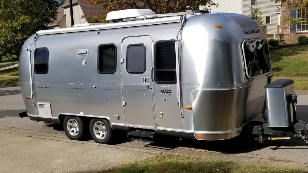

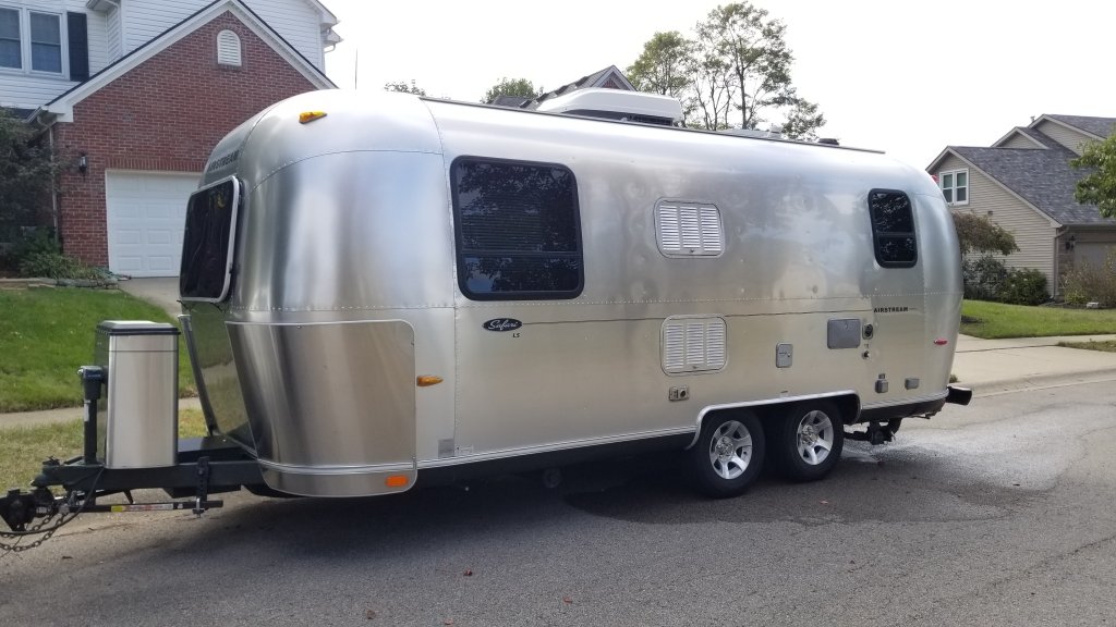

    It's not here so I can't give you the unloaded vehicle weight, but the unit base weight is 4500 lbs (no fluids, propane or options) The UVW is calculated for each trailer and posted in a chart on the galley door. Hitch weight is 600 lbs. (no fluids, propane or options) but with the stuff we always leave in there (kitchen, bedroom stuff, drawers of repair stuff, games, chairs, Christmas lights, flamingos etc.) the tongue weight is 730 lbs. GVWR is 6,000 lbs. It sits low to the ground so it handles very well, but emptying the holding tanks is a real pain because of that.

  25. Jul 7, 2025 at 1:30 PM

    Nice! That's just a little heavier than ours and I'm sure it's easier to tow considering wind resistance - our boxy Rockwood 2502 is basically like towing a brick through the air. I do carry a fair amount in it (but admittedly no flamingos), bringing the weight up a good deal. The last time I put it fully loaded (with some add-ons like solar, extra batteries, Hensley, etc.) on the scales I think it was around 5,400 lbs.
    And of course, you could hand down that Airstream to the kids! Ours is going on 20 years and is doing fine, but I do wonder how much longer . . .
