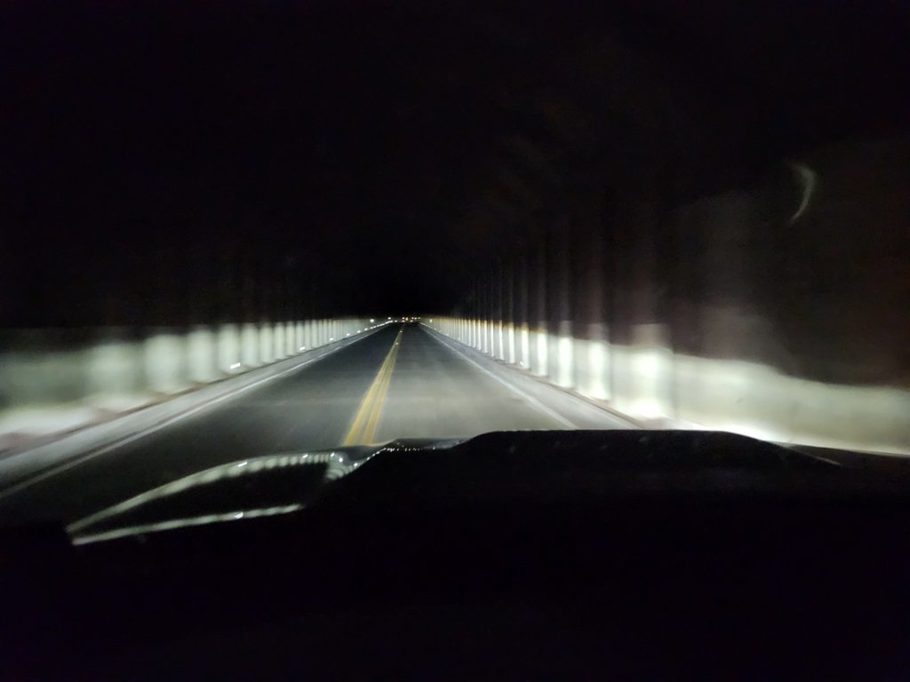

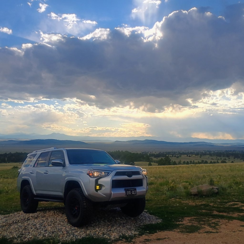

    :fistbump:
    H9, German-made is what I have in the 4R AND MY '17 Taco, and is the best and cheapest low beam upgrade you can do. No light scatter causes oncoming drivers to get pissed.
    The lower K temperatures, "yellow", of the halogen bulb allow superior depth perception and better vision with particulates in the air, rain, snow, and dust. I use higher K LED off-road lights, and that made me put amber/yellow LED foglights in the 4R, Rigid, and KC Gravity my '17 Tacoma. Way back in the early '00s I put 100/80 watt Hella blue H4 bulbs in the euro lights, dual relay headlight harness (no melting and no fires) on my 19888 VW Quantum syncro Wagon GL5, and immediately noticed horrible vision at night in snow and rain.
    The best LED setups are OEM or Morimoto headlight assemblies; all else is absolute junk.
