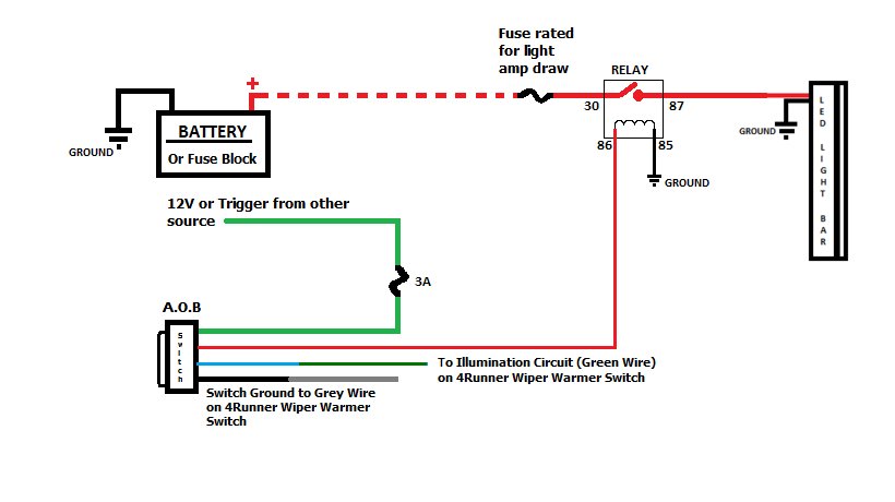

    Use positaps and be confident on your connection.
    The following is what I did when powering my light bar and switch on my 2014 T4R.

    I decided to try the add-a-fuse on the taillight fuse. Electrically it works the way I'd like, so the switches are illuminated when the taillights are on. The advantage I see to this is the power is fused as it should be, and the wiring is still fairly short, even after allowing for enough slack to remove the lower dash panel. Now to run a couple of wires from the relay location through the firewall to the switches. These will be fused as well. I'm switching the ground rather than the +12v side, the wiring is easier that way. I still have to figure out where to mount the relays, but I think this will work but I need to pick up some inline fuse holders for the wires going to the switches. I want to use the same type of fuses as in the fuse block, that way I don't need multiple types of fuses in my spares.
    Also, this way I don't need any positaps to the OEM harness.
