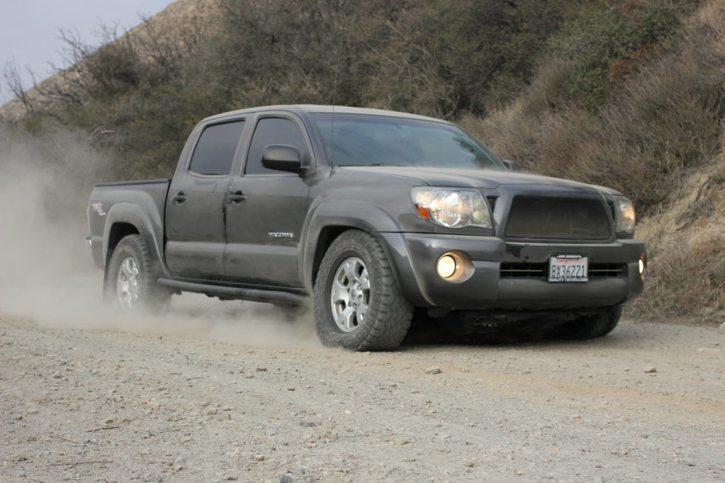

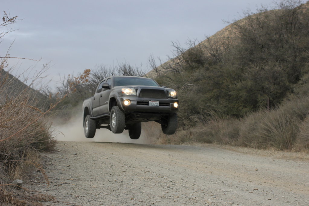

    Ran a set of Bora 1/4" on my Tacoma without issues. I initially purchased them because my tires would rub on the shock reservoirs with my stock wheels. I still have them and may run on the Runner because the front tires sunk in after lifting. I wouldn't get anything like 3" spacers.
    They survived this:
    roooo and nimby like this.

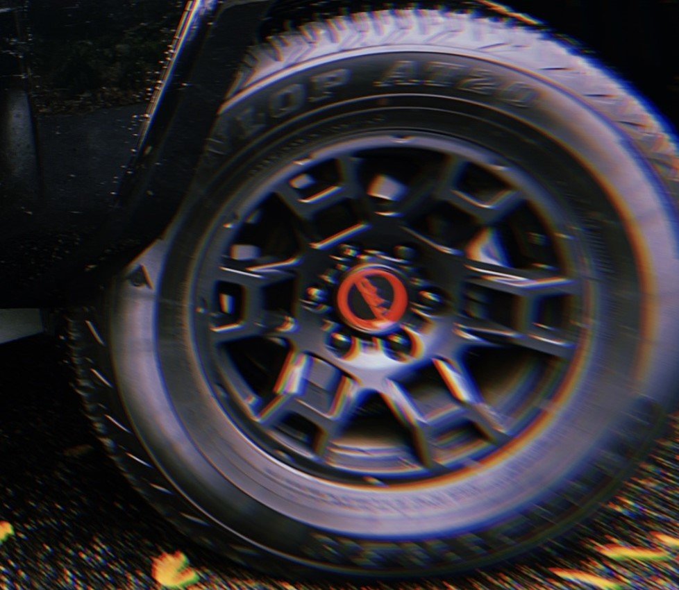

    Would you recommend I just go with a bigger tire for that offset then?

    Wait what exact wheel and tire do you have now?

    great pics

    are you drunk

    he took the pic while the car was moving

    Ahh
    I wonder if anyone was driving

    First thought it was like a bigfoot pic, Pretty good motion on the subject!

    But your underwear.. did it survive?
  19. May 28, 2025 at 4:10 PM
    3,581
    Oh yeah. Not even a skid.

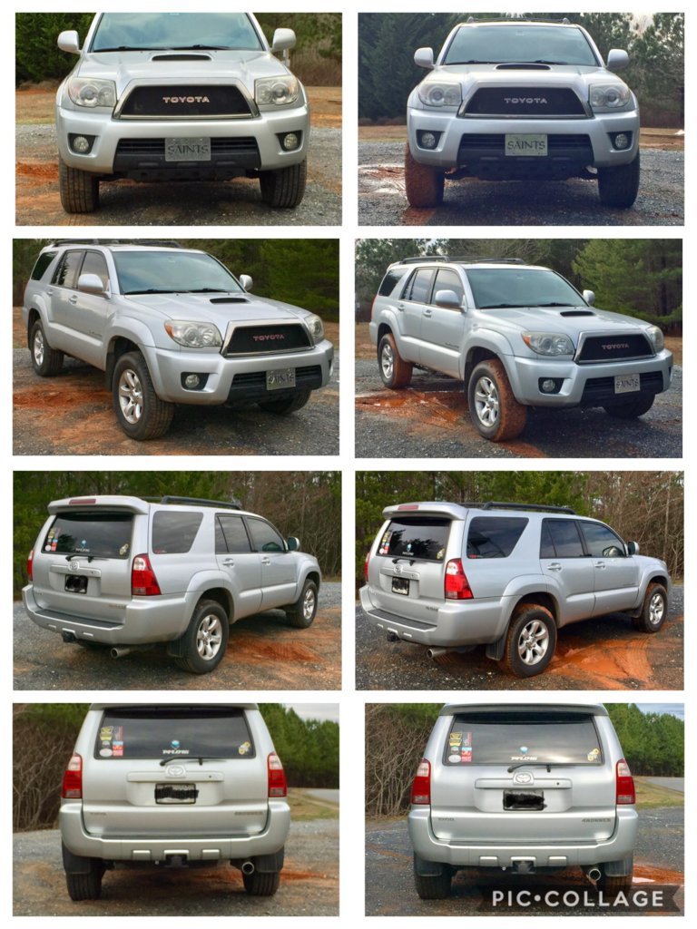

    Just looked at my maintenance log and I’ve had Spidertrax on my ‘07 Sport for 6.5 years and 110K miles. On roads, trails, and rock gardens with zero issues. IMO, the stance is how 4th Gens should look from the factory. Before and after:

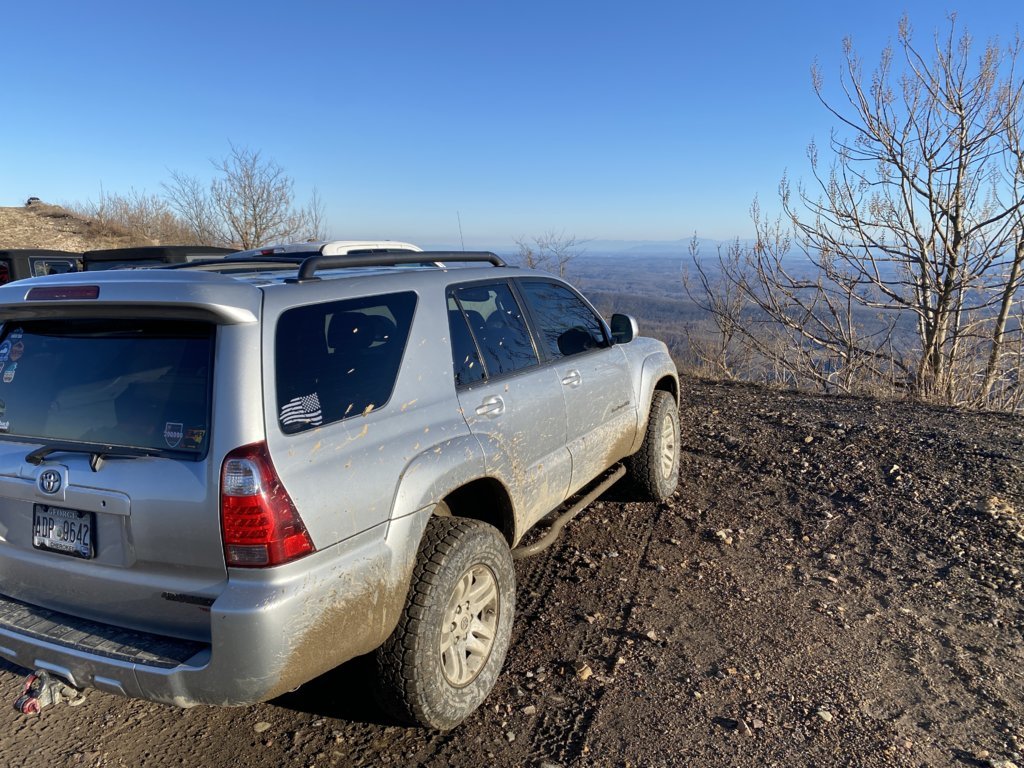

    More recent pic after moving up to 265/70/17 Toyo Open Country tires. Rears look like they’re out past the fenders but it’s just the angle.
