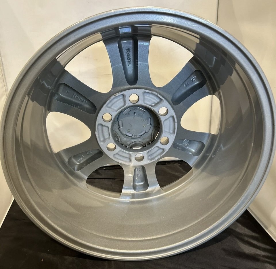

    This particular wheel has pockets between lug holes, so the stud tips protruding past the spacer won't cause a problem.
  6. Jun 5, 2025 at 7:51 PM
    3,129
    These wheels have +30mm offset. Adding a 1" (25.4mm) wheel spacer changes the offset to +4.6mm, about the same as the TRD Pro/SEMA wheels. Effect on wheel bearing wear will be the same as well.

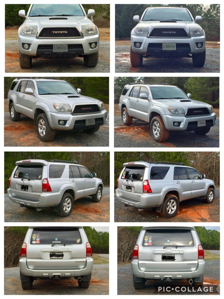

    I had SpiderTrax on those exact wheels. No issues. Be sure to follow the directions and torque specifications and use the prescribed threadlocker.
    Somehow people have gotten confused and put the spacer lugnuts on inside out so double-check. I also recheck the torque every time I have the wheels off. I’ve never found a loose one.
    Before and after (tires were stock 265/65s then):
    And with my current Sequoia takeoffs and 265/70s:

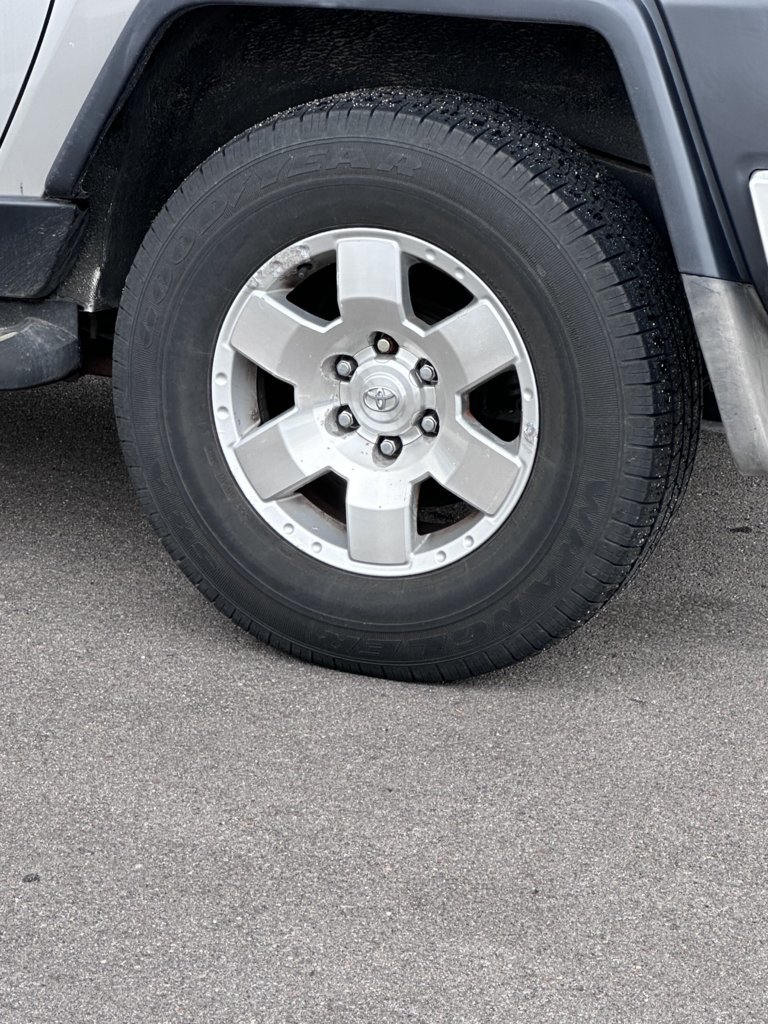

    There’s a set of FJ wheels I really like with 15mm offset, that’s about 1/2” more poke than my stocks. That would be perfect, but every set I find on Marketplace is at least 3 hours away…

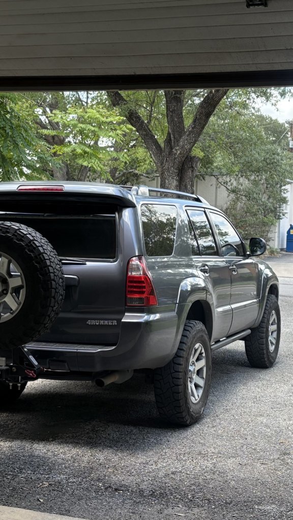

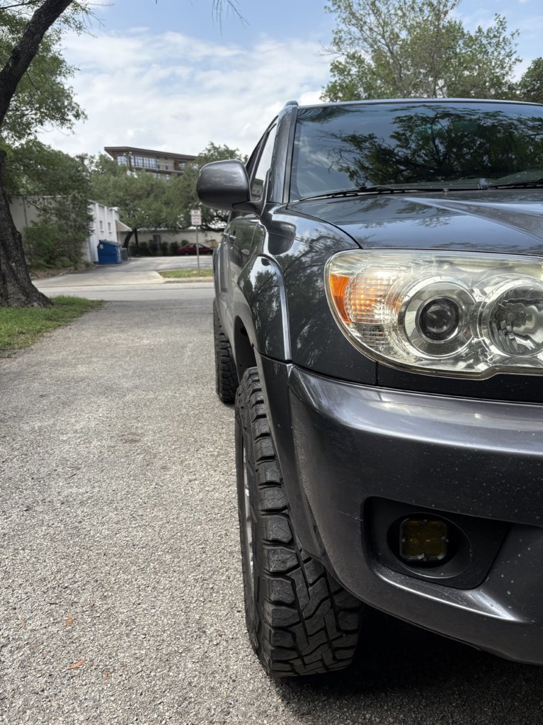

    2008 Toyota 4Runner
    Just put on Spidertrax 1.25” spacers 2 days ago. I like my 4runner even more! :D (Stock 5th Gen wheels)

  10. Jun 6, 2025 at 5:16 PM
    LOSTR4
    LOSTR4 New Member
    #41051
    358
    Just a couple
    Looking sharp!! Good choice!

  11. Jun 6, 2025 at 5:25 PM
    Bluesky 07
    Bluesky 07 Not a New Member
    Jan 26, 2019
    #8560
    717
    Russell
    Northern Georgia
    Looks great. IMO the stance with spacers is how the 4th Gen should come from the factory. Mudflap delete is an improvement too.
