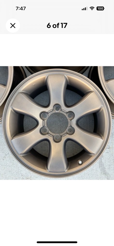

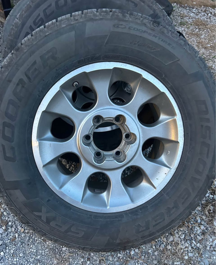

    I like these wheels I found for my 06 Sport (dark gray) but I’m kind of wanting to do a black out… maybe powdercoat them black, I
    can get it done for about $350 total. Kinda hate to do it on these 8-hole wheels (they’re in great shape), I may end up coating my factory 6 spoke Sport wheels in bronze or black. Just looking for opinions, I’ve got the paralysis of analysis.

    ^The 5th gen wheels are +15mm. Depending on the tire you want to run, they may be better or worse for rubbing compared to the +30mm 4th gen wheels.

    I’m just running 255/70/17 AS for now, maybe eventually 265/70/17 but never anything bigger. It’s leveled in the front.

    ^The stock 4th gen wheels will let you run 255/80-17 with no rubbing if you want.
