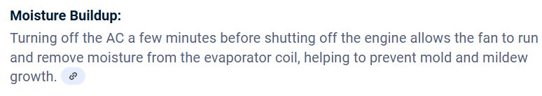

    I generally turn off the AC anyway before shutting off the engine, as I've read this more than once across internet posts:
    It doesn't bother me to hit the AC button after I've started the vehicle next time out.

    I live in south Louisiana where heat and humidity is “King”!
    I never turn off the AC prior to shutting down the engine and never had any issues with that mildew growth as you described.

    Condensation, moisture, and mold still work the same way as they ever did. It’s probably a suggestion that prevents mold buildup over the long term. Personally, I’d shut it off a few minuted before turning it off too, if I could ever remember to do that lol
