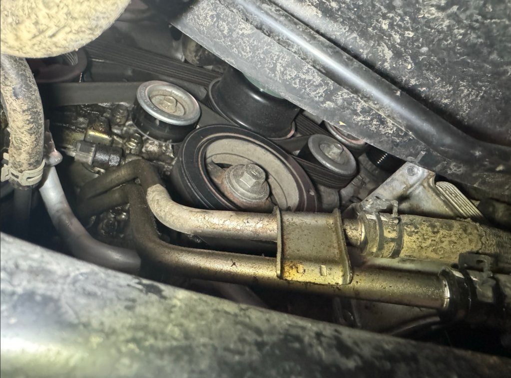

    Seen this when i was doing a oil change 2023 30k miles.
    Should i be worried? Nothing is dripping onto the floor, skid plate is also clean.

    #38203
    308
    valve cover? front cover? looks like engine oil and either way it's not good but probably not catastrophic. clean it and check it daily to find it... no way you'll tell with that mess.

    Bring it to the dealership. At the very least it's documented and in the system.
    I have that same leak coming from the timing chain cover. Its been like that for a few years now and doesnt leak enough to even drip onto the skid. Oil levels seem unaffected as well.
    Yours could be the same, or I've heard there's a line down there that also leaks. VVTi hose?

    I took another look and it appears to be concentrated behind the top black pulley directly below the dip stick on the passenger side, i think it is for the power steering pump.

    Unless it is a leaking PS which is rare, it's either the VVTI line gaskets, timing cover inspection plate gasket or timing cover leak. First 2 are improbable on such a new car but the third is known to happen irrespective of the mileage or age. The first two are easy, the third a pain in the butt.
    Good luck decoding this. But if it's the third, I would sell the vehicle and buy another 4 runner.

    Powersteering pump leaks/failures on 5th gen 4Runners are extremely rare to non existent. While possible, there are other more common causes for leaks in that area.

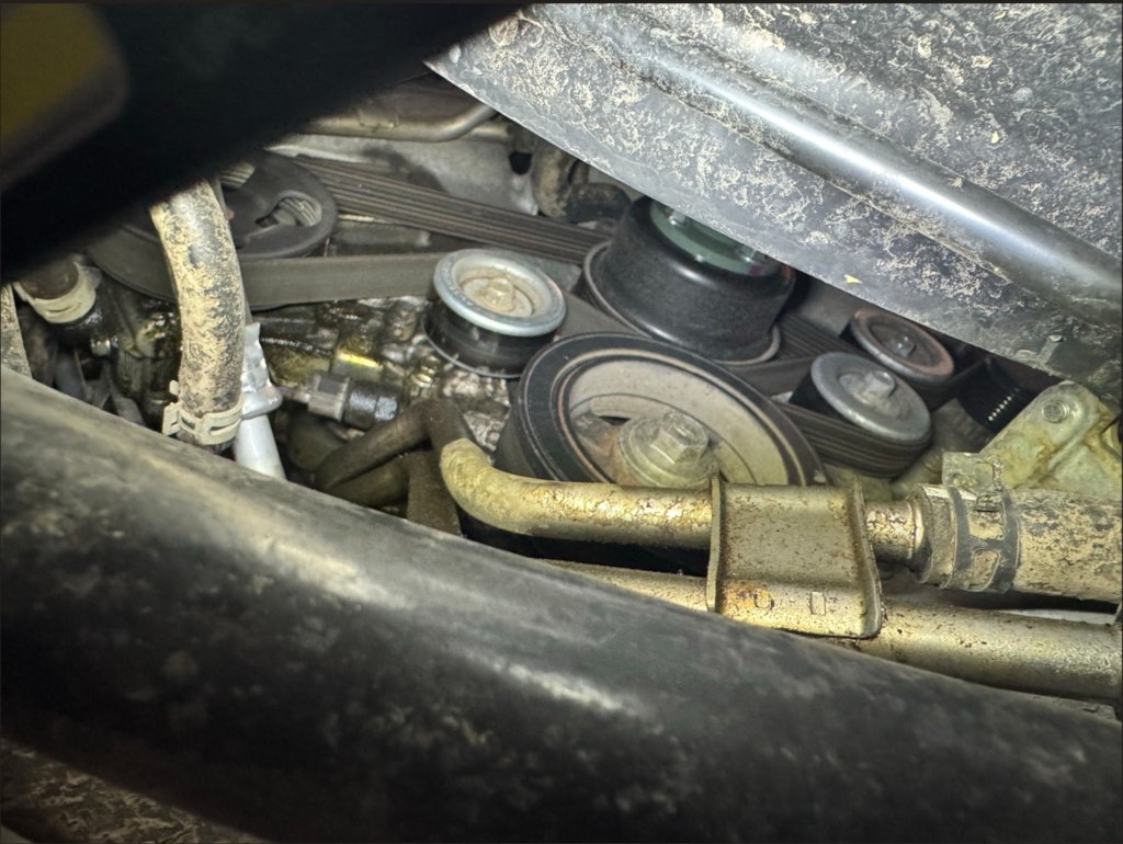

    A few more pics might help and others will most likely be able to make suggestions. Hard to tell from the pic but that yellowish color up in the left side....uhm..looks like oil to me. But I could be wrong.

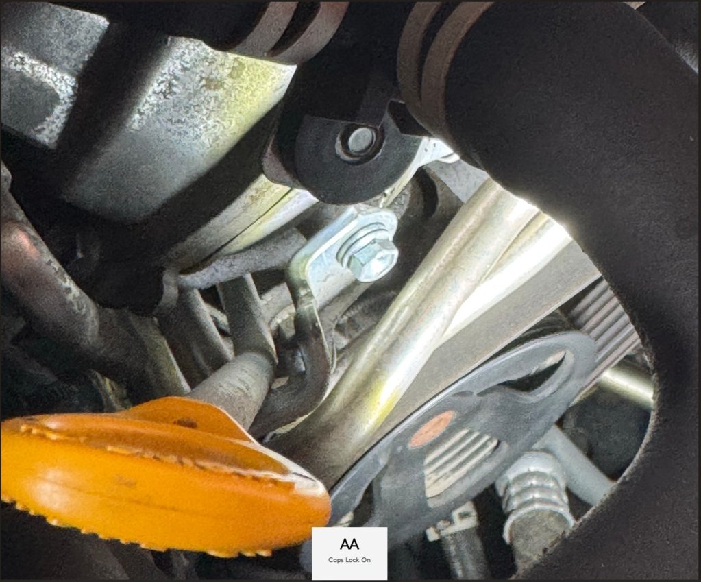

    It's in a tight place where my phone will not fit. I know this pic is crap.
    I need to buy a Articulating Borescope.
  25. Aug 10, 2025 at 7:28 AM
    2,856
    clean it all down to try and pinpoint the source. Does it feel smell like oil?

    Feels like oil/grease haven't noticed a smell.

    I understand your apprehension in terms of working with the dealer but I wouldn't invest too much of your emotion and time beyond scheduling the appointment. This one is on Toyota.
    You will want to know where the failure is but it's hard when it's being distributed by rotating parts, fans and windage from driving. As has been said, if you really want to pin it down in advance you will need to clean it all up and watch for the source.

    If you decide to do some cleaning, cover your alternator with a small plastic bag, and then spray Simple Green very liberally everywhere you can reach with the sprayer. It works even better with a warm engine. You will be amazed how Simple Green melts the oil and dirt off. Let it soak for a few minutes (follow the directions on the container of Simple Green) then rinse with a low pressure stream of water. Do not use water with a lot of pressure as you don't want to get water inside of electrical things such as fuse boxes.
    But I think your best bet is for Toyota to see it when it is messy the way it is now, because it looks like you have a decent sized leak.
