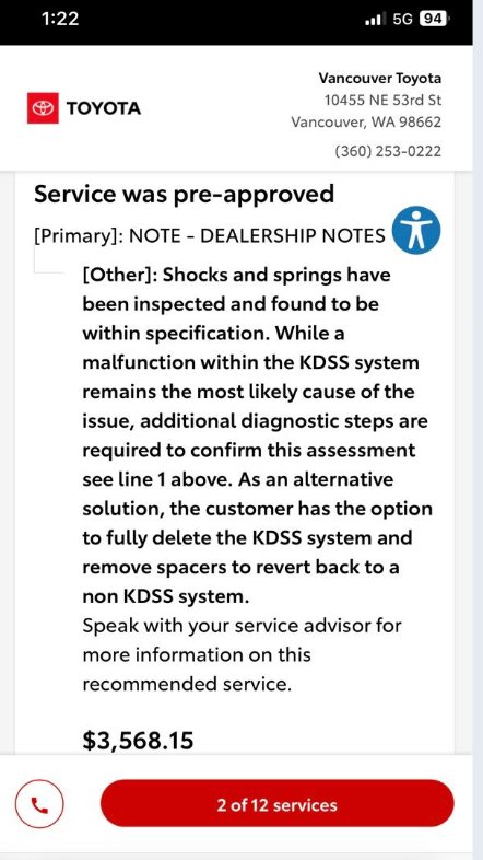

    No, i did not approve anything.

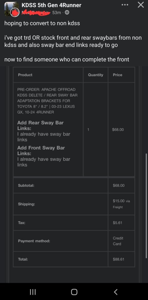

    I know people in KDSS group converting to non KDSS with aftermarket parts.

    If you know of a way to rip out KDSS and retrofit standard sway bars into a 4Runner that was originally KDSS equipped, without welding in multiple components, please enlighten me. Do you see any dealer doing this?

    What exactly do they propose for deleting KDSS? It will take a lot more than removing spacers.

    No idea, waiting to talk to the tech, because serice advisors are as useless.

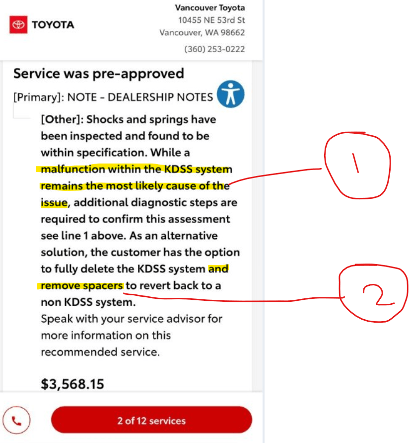

    OP, Also interested to know;
    1) What is the actual issue?
    • Is it a lean you are dealing with? KDSS leans are very common and Lexus already have a TSB to swap the spring to correct the lean. So might be able to fight Toyota go get it fixed under warranty while not stripping the the entire system.
    • Is it a KDSS ram leaking and have KDSS light on? This is also common. Leaking front ram is very common due to use. Just like shocks they wear-out and can be replaced. Last time I saw the parts was about 1800bucks here in Denver CO. Rear ram leaks are rear but happens.
    2) Whats with the spacers?
    • Are you having a spacer lift causing problems?
    • Or are you having issues with bushings using KDSS spacers?
      • In this case I would take it to a Toyota specialist 4x4 shop to diagnose and the fix would be a better option than stripping the entire KDSS system.
    In short what I wanted to tell is you can fix KDSS issues ("all issues I've seen with KDSS"). And then maintain it to reduce the problems in future. Converting to Non KDSS should not be the ONLY option.

    Hopefully not but maybe the tech is thinking its XREAS.
    If tech is thinking that then I'd find another dealer.

    Even with 1/2 inch spacer on front right strut, and 10mm OME spacer on rear right spring, i get a lean, sometimes as much as an inch. I wanted the system bled and re-pressurized. The previous owner had a 2 inch lift on the car and it was leaning. it's back on stock springs now. So, there is mechanic at this dealer who supposedly is a guru, and has dealt with multiple malfunctioning KDSS systems. Well, the service advisor screwed up , of course, and the mechanic can't work on my car, and only his subordinates do. Well, about an hour and half into the service, i get that message above. Things are going downhill fast.

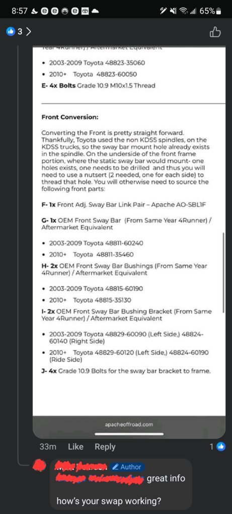

    And regardless, I’ve heard that there aren’t any threaded holes in the frame for standard swaybars, and IIRC you can’t fit the standard swaybar links on the KDSS spindle.

    You also have to weld on all of the brackets. I suppose if you've done it a few times, it's probably not hard. But, it sounds odd for a dealership to do this.
