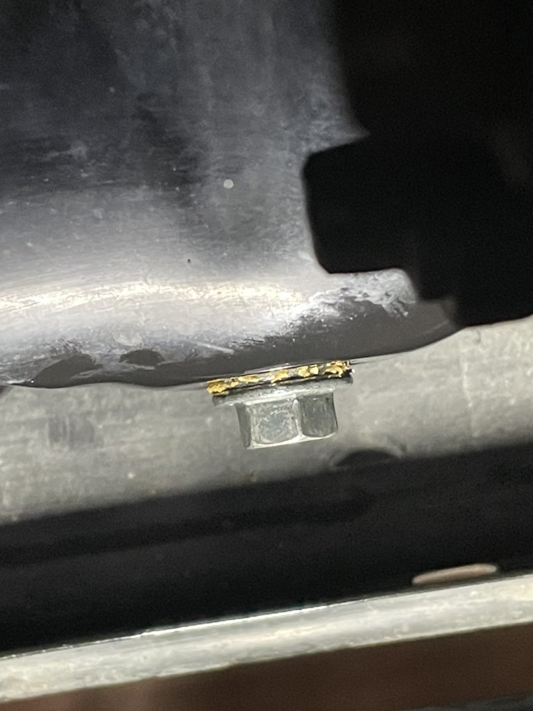

    -a new drain plug crush washer

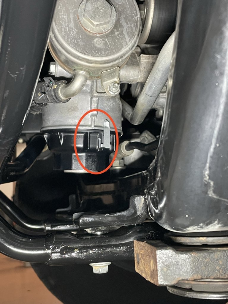

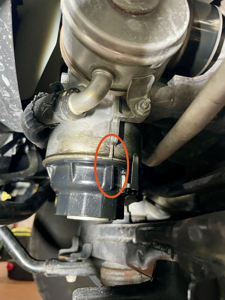

    Understanding all of that... holy shit, 96 foot-pounds of breakaway torque on the filter housing! Lug nuts generally were around 90 ft-lb, with one just over 100. Not great; not terrible. Tech needs a new torque stick or needs to recalibrate his ugga-duggas. I have no idea WTF gasket is on my drain plug, but it was close to the correct 27 ft-lb.
    In the pics you can see before/after position of the tab on the housing when torqued to 20 ft-lb. I installed a new OEM filter kit but did not replace the drain bolt gasket; that can wait until I change the oil, unless it starts leaking.

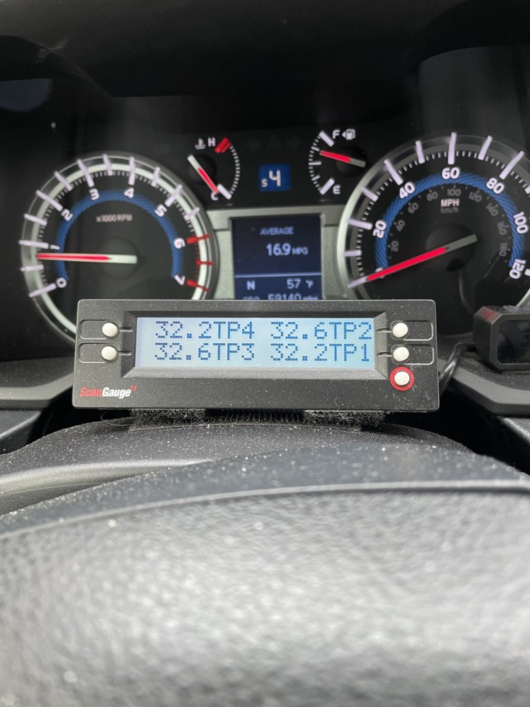

    My tires have a paint color marker on the TPMS stem because my Scanguage 2 gives a tire pressure readout and I match the color/tire to the pressure , also I can verify the rear cross rotate I request.
