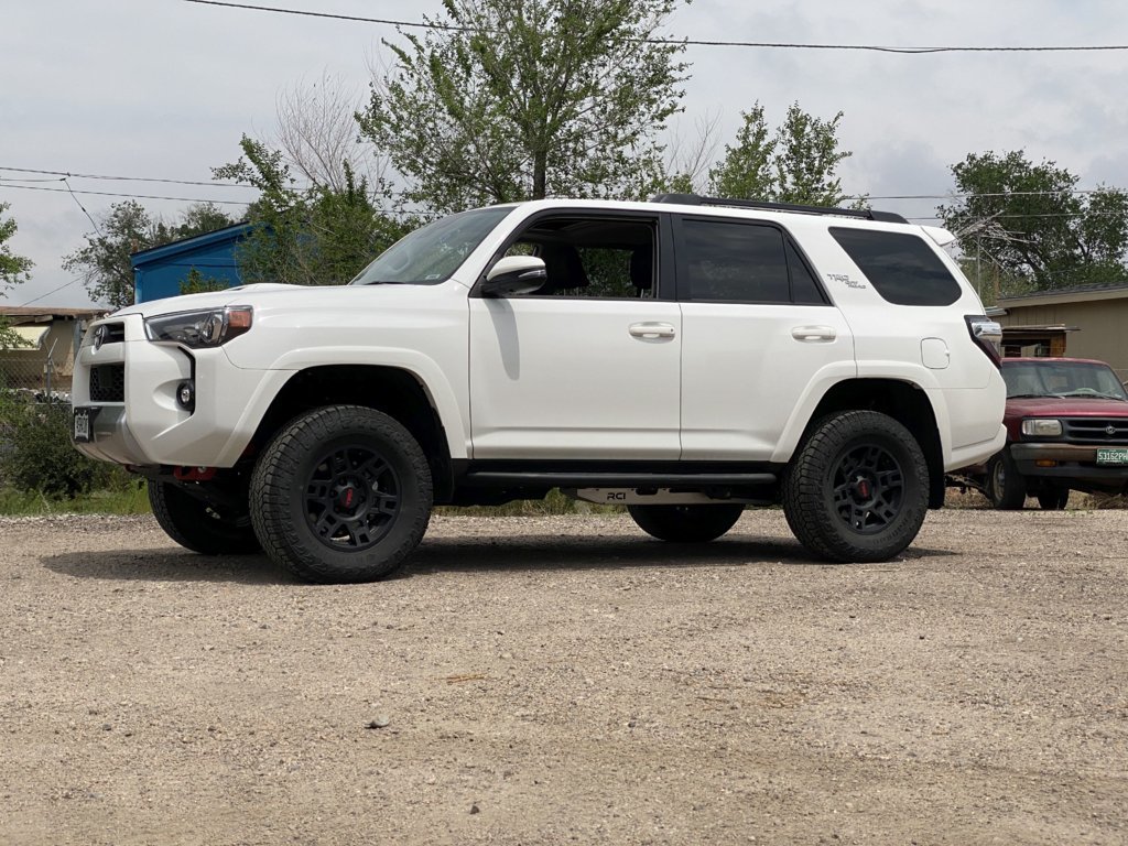

    After installing an RCI full skid plate set which pulled the front end down about 1/2" from stock, figured I would do a mild lift/leveling with the Eibach Pro-Truck set plus new springs. Just finished the install yesterday. On the front, I have PRO-TRUCK SPORT FRONT HEIGHT ADJUSTABLE SHOCKS with the ring set on the bottom/lowest position. For springs I installed Old Man Emu 2883's, listed to provide 2" of lift. And added Eibach Pro-Lift-Kit Rear Springs w/1" lift. After the install, the truck now has a REAR rake, with the front end about 1/2" above the rear. Doing the measurements and math, the rear gained about an inch, as expected, but the front gained a whopping 3.75", even with all that steel under the front end! Checked the part numbers and all looks right. Any idea what I did wrong? Thinking of pulling out the OMEs and reinstall the OEM springs on a higher perch. As it is now, there is too much CV joint angle to drive the vehicle. I welcome any suggestions!

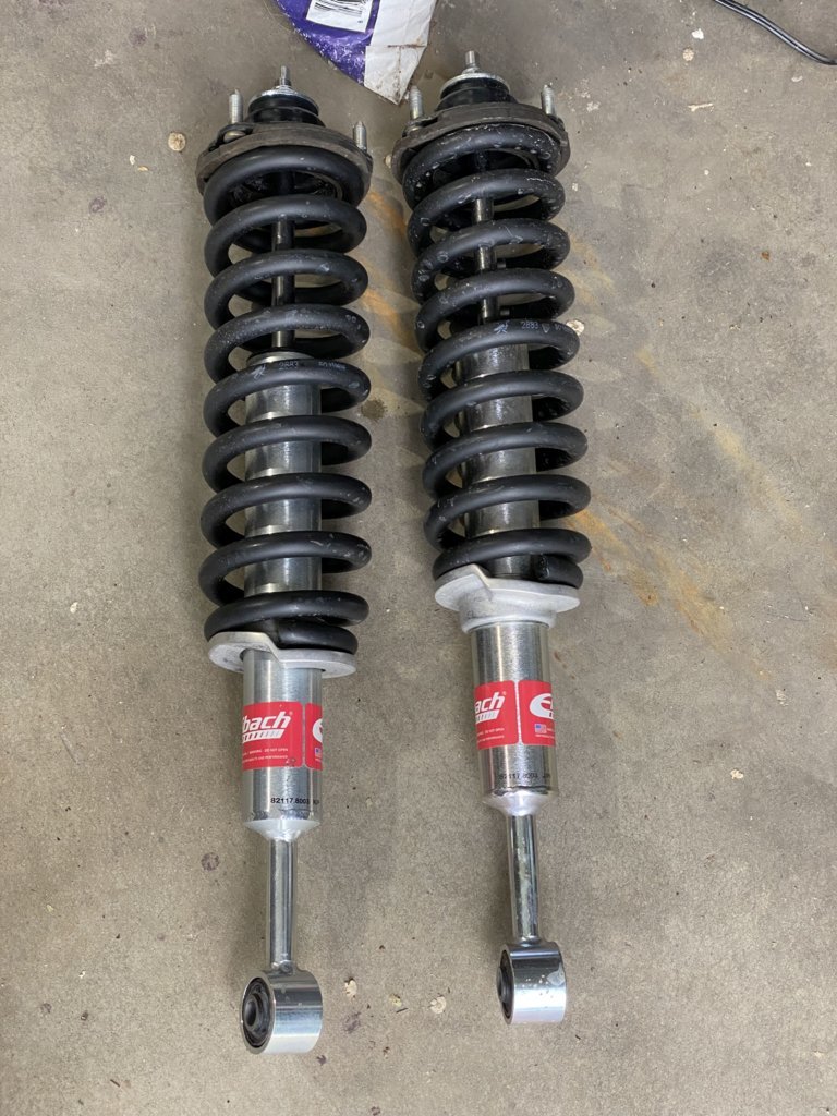

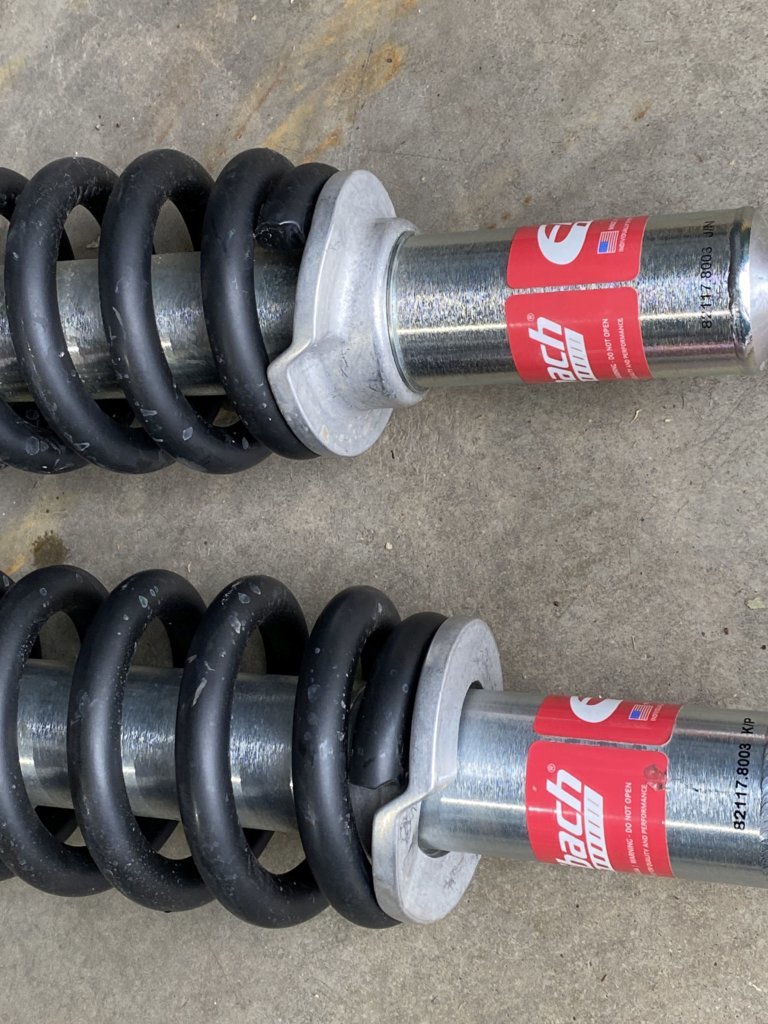

    When unexpected lift happens in front, often times people accidentally have the lower spring perches upside down.
    Could this be your issue?
    Are you sure yours are the correct orientation?

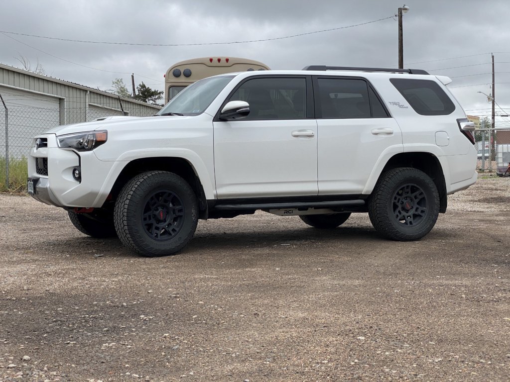

    Y'all nailed it! I put the spring perch on upside down. Doh! Flipped them over and surprisingly it works out much better... lol. Photo showing before and after flip on the assembly.

    It sucks to have to re-do the whole disassembly / installation again but glad it was a relatively easy fix :thumbsup:
    Looks much better now!
