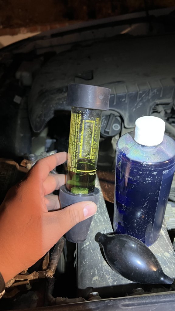

    It looks like I’ll be picking up a combustion leak detector as well then to see if this is the cause of my issue I feel I’ve exhausted almost everything else.
  23. Aug 27, 2025 at 5:34 AM
    3,413
    ^Time for a lower-mileage used engine. Tacomas had this engine up until 10 years ago (2015), though I think you'd need to block off the exhaust manifold air injection ports.
