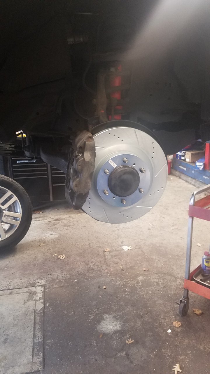

  8. Nov 26, 2018 at 11:10 AM
    Kennyp
    Kennyp [OP] New Member
    Oct 20, 2018
    #7518
    35
    2011 Magnetic Grey 4Runner Limited
    I just had rotors and brakes replaced today since I'm trying to troubleshoot the vibration anyways....they were sitting at home. I made the investment and got Powerstop rotors and brakes. So after rotors,brake and tire rotation, Im still having the vibration around the same speed. One thing to note is that after balancing was done, the guy at the shop said he is not 100% because these wheels require high speed balancing. So I'm sitting at Toyota waiting for a diagnosis. I have to suck it up and pay the $130 if I wanna know what the heck is happening here. This truck has an extended to 150K. I've only just done 57K.
    I'm hoping it this is just wheels as you suggested.
    Thanks
    4runningMan likes this.

    How do like the Powerstops?
  10. Nov 26, 2018 at 5:15 PM
    Kennyp
    Oct 20, 2018
    #7518
    35
    They feel way better than stock. They feel firm and there are no squeaks.
