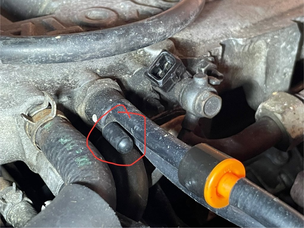

    pic 1: Throttle Body

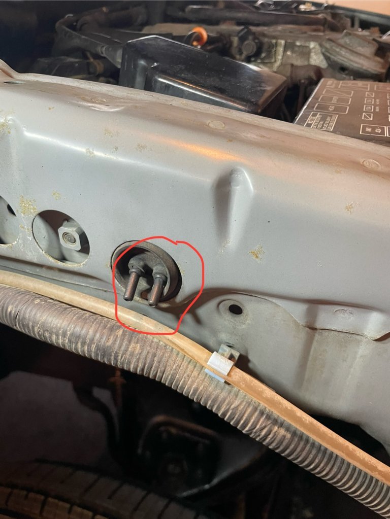

    pic 2: off bottom of Power Steering Pump

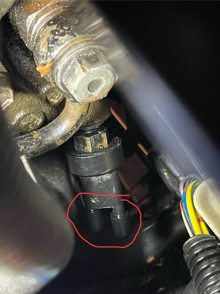

    pic 3: Passenger side of the Plenum

    Pic two. A vacuum switch to raise the idle speed when turning. Not sure about the source. Mine's capped as well.

    Pic five. That one is kinda funny. Looks like a vacuum port, but I'm pretty sure it Is the supply piping for the front and back wind screen wiper fliud.

    Pic three? there is a plug-in there that should have a connector. That gadget injects fuel for cold weather starts. Kinda like a choke. The wiring for that plug should come out from under the plenum with the hose to the injector. That hose comes from the passenger side fuel rail.
