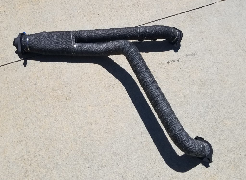

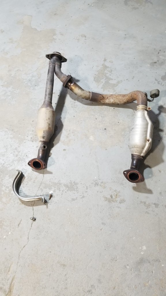

    Ultimate cat protection mod. Been wanting to do this mod since i bought the TuRD many moons ago, more so after adding the blower. Life always seemed to get in the way, along with URD never having them in stock. Turns out the planets aligned and i got one second hand from an unfortunate individual that came down on orders to one of our police states. Any who... I primed and painted the pipe with raptor high heat paint. Wrapped it in fiberglass heat wrap and tossed it in. Old pipes came out with little fuss other than the metal band over the driver side cat (no idea what it was for, looks like a drive shaft loop).

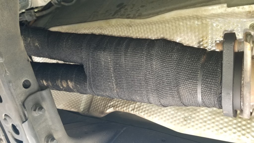

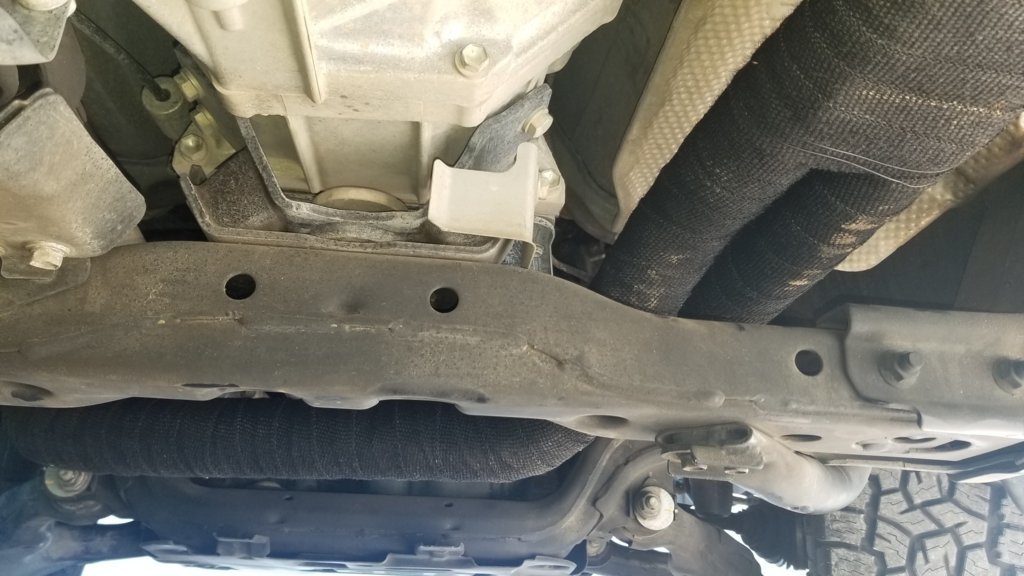

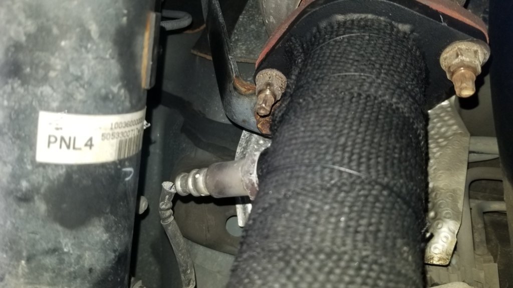

    Fit was precise, maybe to a fault. Required mounting it to the "cat back" first, then the manifolds. Once i figured this out, it was a breeze. The location of the driver side 02 sensor, requires installing the sensor after the flange is bolted down... up... in place. (Learned that the hard way also). Removal and installation took about 45min. With the help of a cheepo cordless impact. Requires 2 new flange gaskets and the rear "doughnut" gasket thing (i was able to reuse my old one).
    No codes have been thrown according to the scangauge III. Truck is now light speed fast... or not, but it gets into the higher rpms faster (removing 3 restrictions will do that i guess). It is quicker, by how much is hard to say. It is a bit louder, but barely notice it. Louder the hotter the exhaust gases get. If that makes sense. Not obnoxious, barely there, but i have been on the wrong end of an RPG a time or two. Still can't hear it over the radio.
    I think the acceleration stink is less, but still need the paint and wrap to finish "gassing" to be sure.
    My .02, i'm happy with it for now and would recommend in over a cat back for 1st exhaust mod. Kinda want to do headers now, but can't stand the install process. Anyway hope this helps someone out there on the interwebz.

    Any worries about trapped moisture on bottoms of wrap causing temp. driven cracks like you see on some motorcycle exhausts?

    My understanding is the paint will provide protection from said moisture. The fiber glass was also treated in a silicone protectant to repel water. At least that's the rumor. Any moisture should be burnt off next time i start the truck. Worst case it rots out and i put the stock pipe back on, leason learned for next time.

    Why did you paint and wrap it? It's stainless

    Wanted to play with the heat wrap and everything i've read said paint would help with corrosion. Tracking the wrap won't last long enough for it to be an issue, either way. Where did you find one? I've been looking for a long time.

    The downstream sensor is on the factory Y-pipe. When you replaced it with the URD Y-pipe, the sensor needs to be installed on the URD Y-pipe. There should be no empty sensor holes to block off, unless you modified the Y-pipe?

    The 2024's have three OBD2's in the mid-pipe? The 3rd bung in the URD is for a wideband and has the supplied plug if not used.
