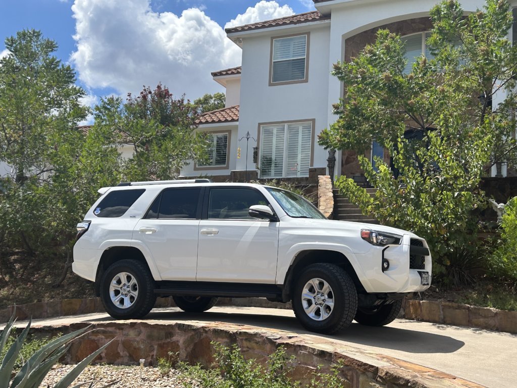

    Welcome! I have a 2022 SR5 Premium 4WD. I had a local off-roading shop install a set of Bilstein model 5100 adjustable shocks for me. Set to lift the front 1.85”, IIRC. No other suspension mods.
    I did switch tires though- I went from the factory Dunlop all seasons to Sumitomo Encounter ATs, in the stock 265/70 R17 size, with the SL load rating.
    I don’t off road. Not yet anyway. I am however properly exercising my 4WD in 4H and 4L to keep it from freezing up.
    I’m very happy with the Bilsteins, and the Sumitomo tires. Never heard of Sumitomo tires? Sumitomo Rubber Company of Japan owns Falken Tire.
