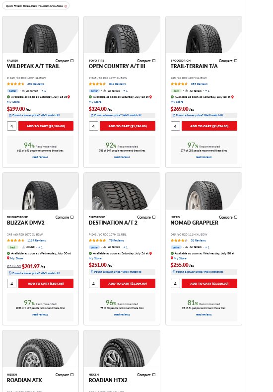

  8. Jul 25, 2025 at 3:36 PM
    5,664
    I'm a big fan of 17in wheels and tires. Its not an expensive upgrade either. TRD Offroad wheels are very reasonably priced in used market. They are far less weight than 20in wheels. With stock size 265/70R17 tires you have insane amount of tire options. Unlike 20 in you have to settle for tires like non-snow rated Micheline defenders you have a huge range to select all weather tires, All terrain tires, so on and so forth.
    Also if you have someone in your house hold who doesn't care about curbs and potholes 17in wheels and tires are miles ahead of 20in minivan options.
    Edit -
    Just did a search, Dang, there are only 8 snow rated tires available in size 245/60R20 at Discount Tire. Vs 265/70R17 have 71 snow rated tires available.

    Thanks for that information about snow rated tires! To be fair, in the last 5 years, we have averaged 3-5" of snow here around Sedona. That is not for a single storm, that is for the whole winter. We did have one year when we got about 13" of snow, but that was all melted by the next afternoon. I lived above 7000' in the Colorado Rockies for 50 years (after growing up in Minnesota) so I have pretty good experience with snow rated tires. They certainly have their place, but they are not a priority for my use case here in the Arizona desert, just a factor to consider.

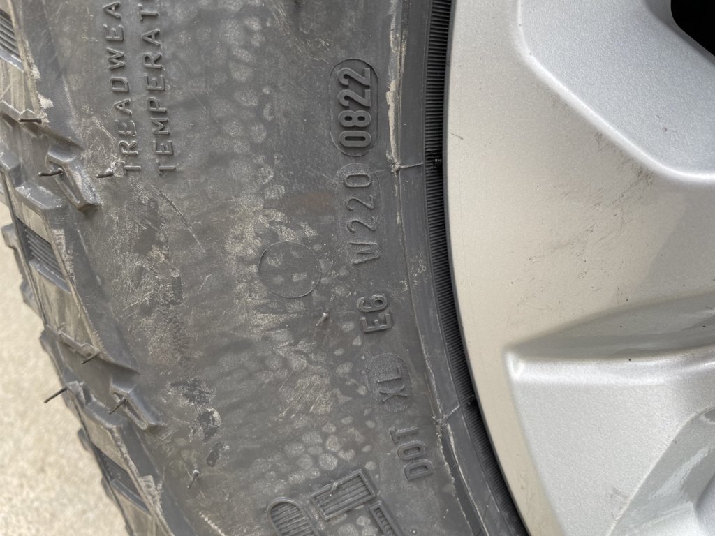

    I think the DOT label molded into a tire is definitive. Double check with max tire pressue also on tire.
    My Pirelli Scorpion AT+ are in literature as SL. But tire DOT says XL and max 44psi also confirms XL.

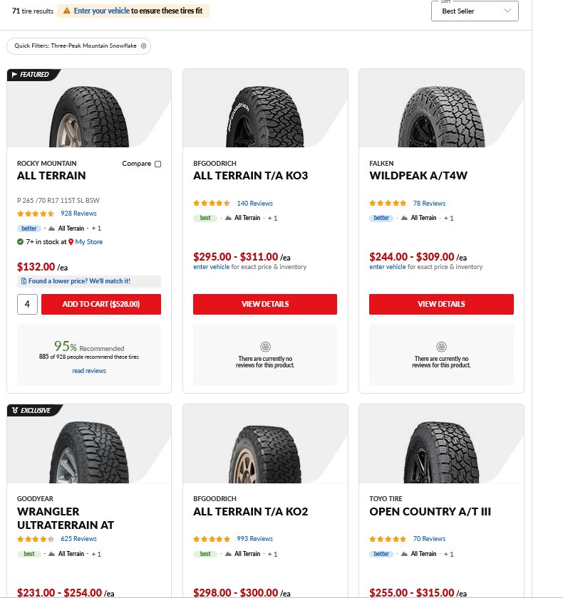

  15. Jul 26, 2025 at 7:25 AM
    5,664
    In tire size 265/70R17 there is Goodyear Assurance WeatherReady2 that were most likely made after seen the success of Micheline CrossClimate2. I have 2nd hand experience with older WeatherReady tires. But looks like OP doesn't need snow rated tires. In that case Micheline Defender would be the best choice for the pavement imo.

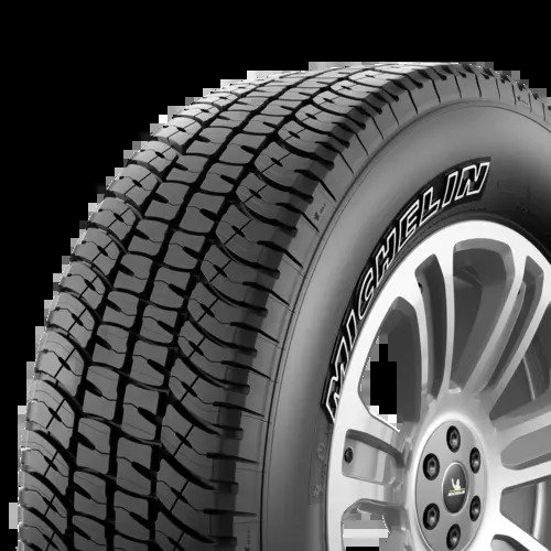

    Here are my current thoughts about the 20" Michelin Defender XL load rated tires compared to some of the reviews from other owners. My 2024 Limited with Xreas suspension has a different, softer, more compliant ride quality, less stiff, than the other models. The current SL rated Geolandars just seem to wander a little too much with the 4500+lb vehicle weight and the Limited suspension at 75+mph highway speeds (my use case), which seems to be about the weight limit for my truck with SL rated tires. I am thinking that the XL rated Defenders might give a more planted highway handling with a less jarring ride than they might on the other model suspensions. Is this wishful thinking or is the Limited a better suspension platform for XL rated Defenders for my use case of western US road trips?

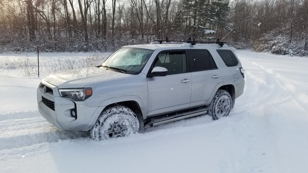

    How did the Yoko's work for you last winter?

    Do not be afraid of the XL rated Michelins. I have them on my OffRoad Premium and they are fantastic tires. The XL in the new version of the Defender MS2's just has a very slightly "beefed up" sidewall resulting in a very slight increase in load index (like 113 on the old version to 116 on new version or something like that). Just barely a change.
    I read that they went to XL due to all the new electric/hybrid vehicles getting heavier. But it's not at all like going to an LT tire. The XL's are still much more in the ballpark of a P rated tire.
    You may not even notice the XL difference on the 20 inch limited tires. I bet the change for you would be more subtle than on the 17 inch tires on the other trims.

    I bought the Limited in December and there has been no snow here to drive through since then, only occasionally wet roads.

    Understood, but basically you've been through a typical-ish winter for your area. I'm just suggesting you have something of a feel for how the Yoko's do in "weather". I like Yokohama but would not mind having a set of Michelin either. You are right that your current tires are as valuable as they will ever be right now. I don't think you can go wrong either way.
