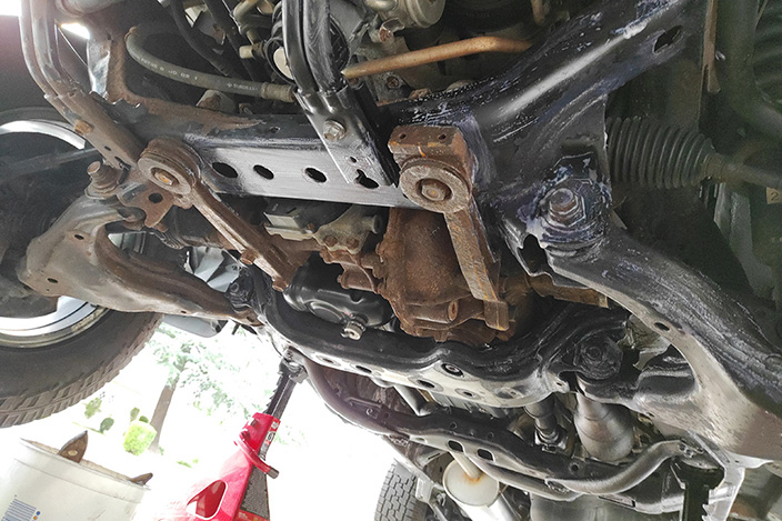

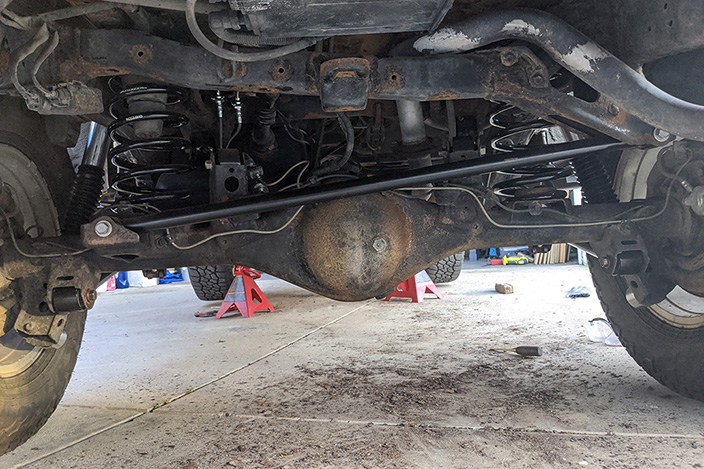

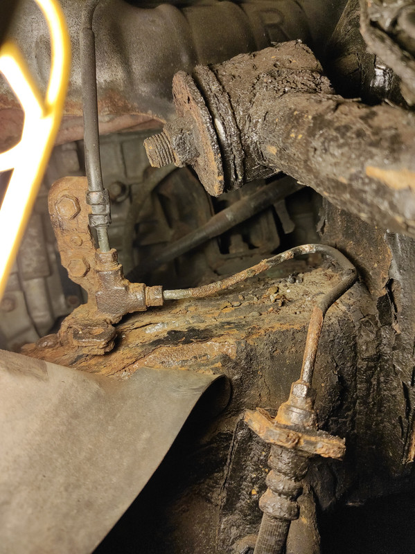

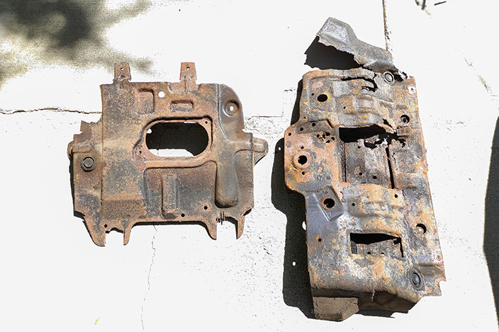

    Condition of the Undercarriage
    Condition of the undercarriage upon purchase of the car left a lot to be desired. Skid plates and spare tire were simply scraps of metal that soon found their place in a trash bin. Bed floor had a large hole, all of the components were covered in rust, paint was peeling and bulging out in any location moisture could get through.

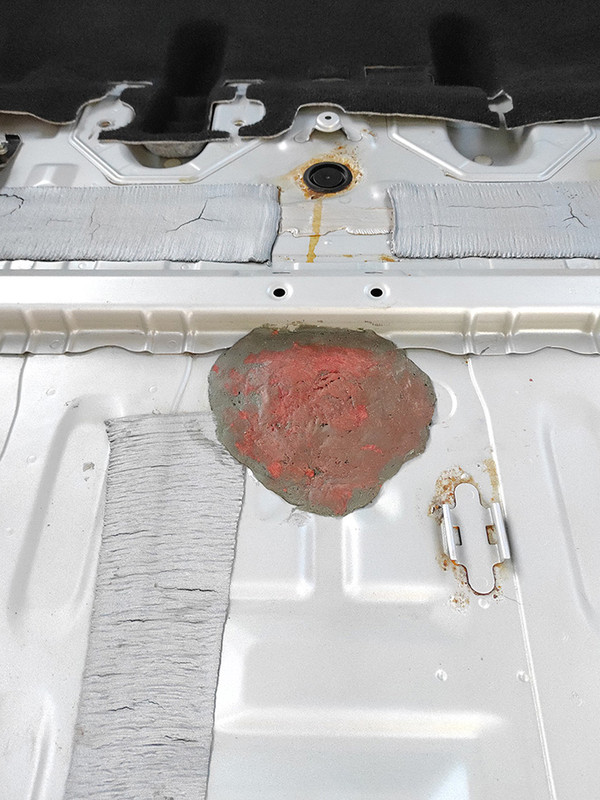

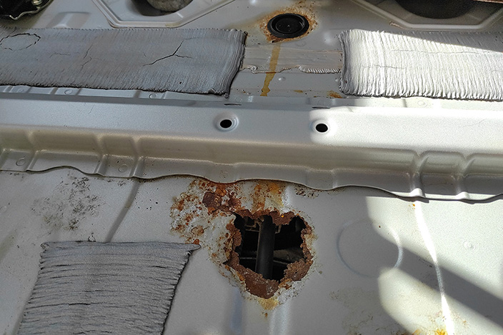

    Fixing Bed Hole

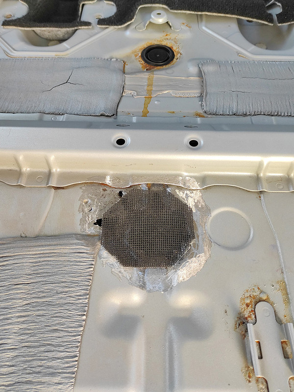

    Patching bed hole was a simple fix. I sanded the surface with rotary tool, and applied drywall sanding screen on top of it to provide reinforcement.
    After covering the hole with Bondo Fiberglass Filler the problem was solved.

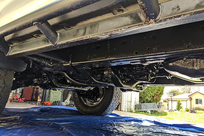

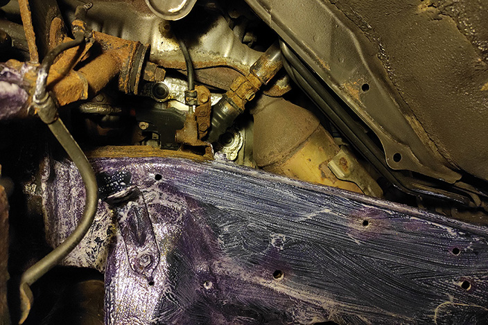

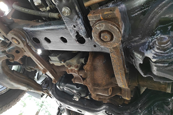

    Initial Attempt at Undercarriage Rust Removal and Undercoating
    Initial attempt at undercarriage rust removal and undercoating was a bit more complicated than the second one. I used all the tools available at my disposal to prepare the surface before applying rust converter. Wire brush, angle grinder with wire wheel, chisel, and screw driver got rid of most of the the rust and loose paint. The surface was then degreased and thoroughly cleaned, before application of several coats of FDC Rust Converter Ultra.
    The surface turned purplish in color after the first application, and then eventually turned dark as this stuff dried.
    Final Result
    After the surface was fully dry, I applied 3-4 coats of Rust-Oleum automotive rubberized undercoating. The final result was very satisfying.
    Assuming that these steps would be enough to protect the car from formation of new rust, I stopped here. 6 months later, after one Colorado winter, newly sprayed undercoating was showing signs of rust once again.

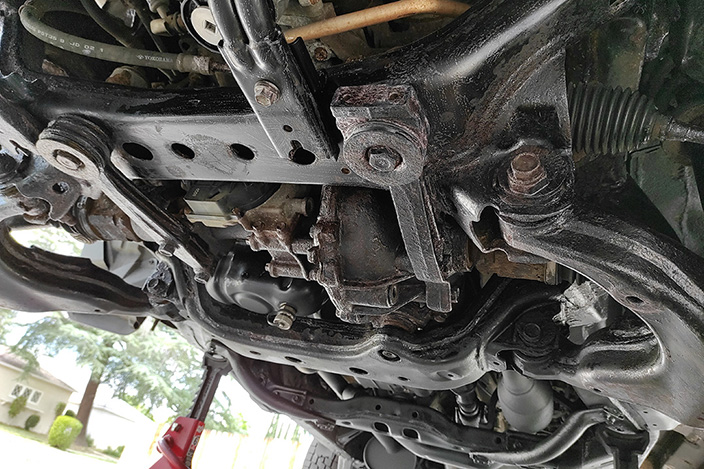

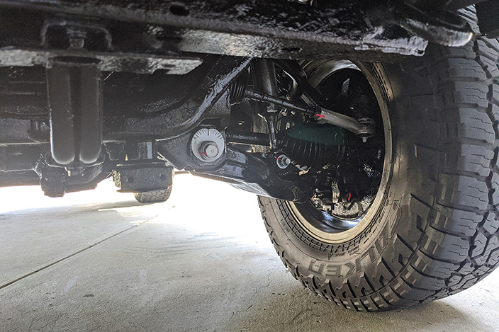

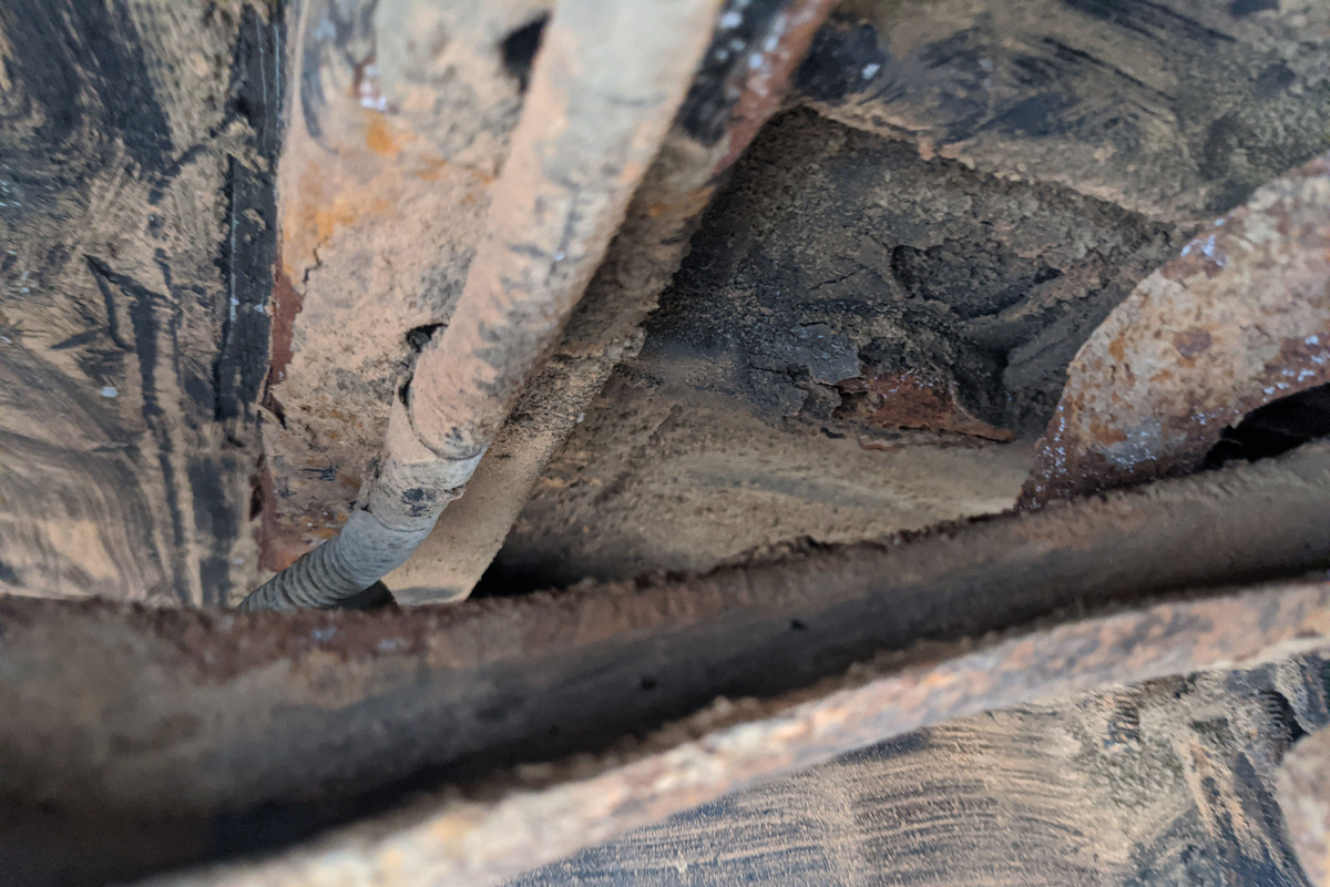

    2nd Attempt
    Initial attempt at rust removal and undercoating undercarriage didn’t prove to be a success. After spending winter time in Colorado, rust started to reappear above undercoating. Undercarriage of the car was slowly returning to the same condition as before. After some research I came across a forum post about Fluid Film where the same thing was mentioned.
    The factory paint doesn’t last one winter, nor does an aftermarket paint product. Is it better than doing nothing? Heck yeah. And if you keep on top of it then it will work great. But it isn’t some spray it and forget it solution that people think it is. You would have to reapply it every year or two to prevent rust. The stuff they use on the roads here is just that awful. We have brand new vehicles for sale with rust on the frames because of test drives in the winter. Buying a 2023 in winter of 2022? It will have frame rust already.
    https://wranglertjforum.com/threads/fluid-film-black-vs-fluid-film.65188/
    This time, I spot cleaned everything I could reach with a my hands.
    I ordered a gallon of black Fluid Film along with a cheap spray gun from Amazon. Since I was doing it in my driveway, I covered area under and around the car with a cheap tarp from Harbor Freight Tools. I also bought myself hazmat suit from Amazon for personal protection.
    It is mentioned in many places on the web that Fluid Film needs to be heated to proper temperature before applying it. I decided to follow this advice.
    I had a few doubts before applying this stuff. First, it seems like people usually apply it once a year, in late fall. Second, sand sticks to it. The timing just didn’t seem right. I was was planning a road trip that would take me through pretty rough terrain, which would be covered in dirt, gravel, etc. It was also the beginning of summer time.
    I thought that some sort of protection is better than no protection at all, and went ahead with application. The whole process took me about an hour, not taking clean up into account. I ended up using entire gallon. Sections that were difficult to reach I covered using small brush.
    After application of Fluid Film, I wiped off areas where important fasteners were, and applied Torque Tamper Detection Marker.

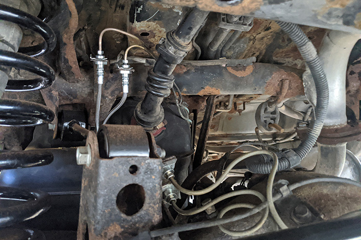

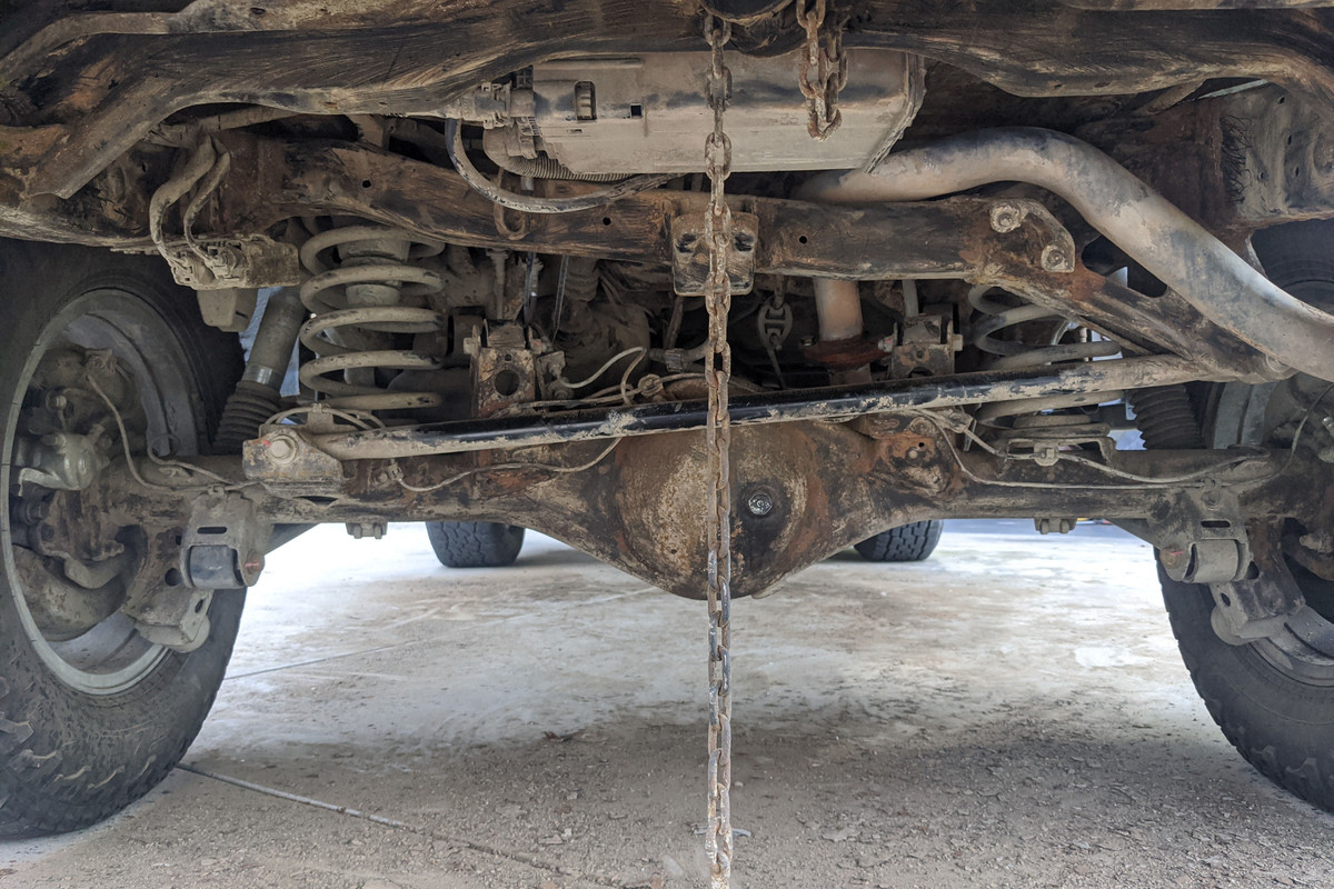

    Afterthoughts
    After application of Fluid Film I drove through dry and dusty areas of the American West. Most of the driving was done during the summer time. Except several water crossings in Utah and frequent rains storms in the North of the US, the undercarriage stayed mostly dry. All the dust that collected on the Fluid Film and hot summers have created a layer of dust that looks like rust because of the color of the dust in Utah.
    I am not sure how much moisture protection I am getting at this point. Probably none. Underneath that layer of dust is a rusty a rusty undercarriage. New suspension components that were covered in Fluid Film have developed spots of rust all over them. Very strange. Not sure if Fluid Film and dust had anything to do with this.
    I will have to redo the whole undercarriage the third time. I live in the Southwest of the US, but travel frequently to other areas of the US where moisture is a problem. This time I will definitely avoid using Fluid Film and will try POR15 instead.

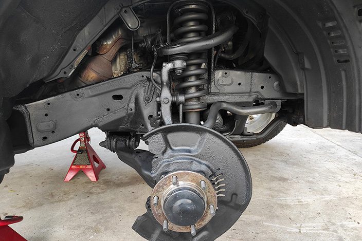

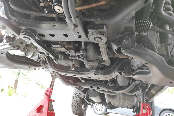

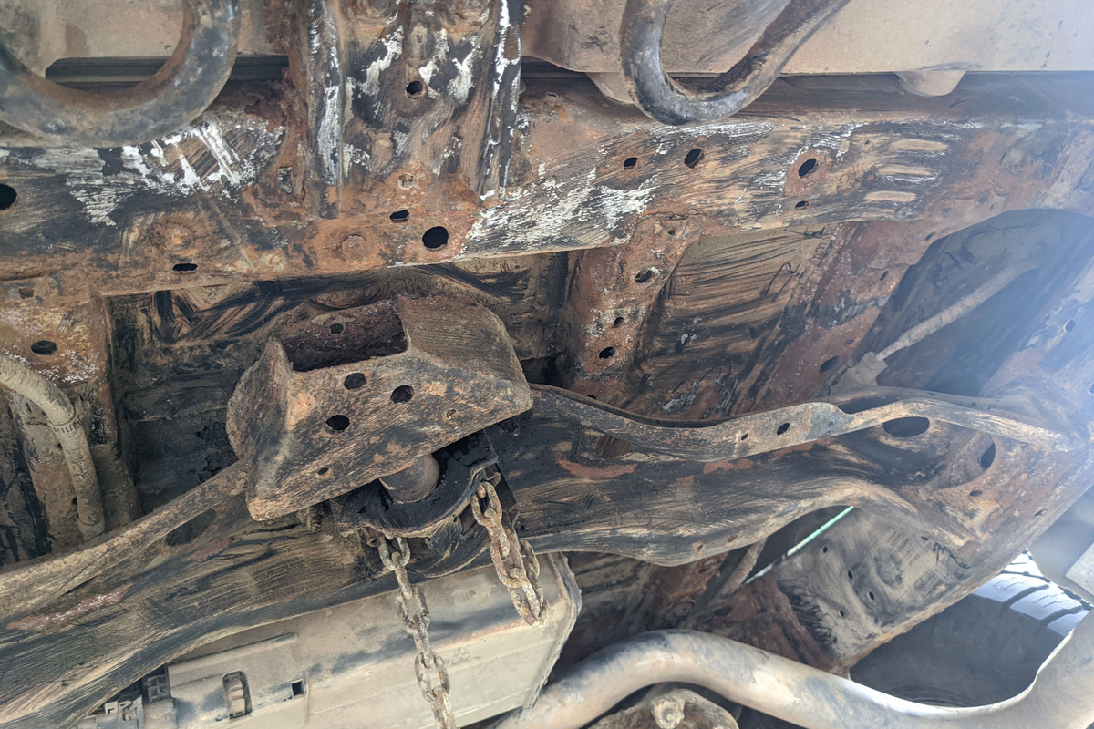

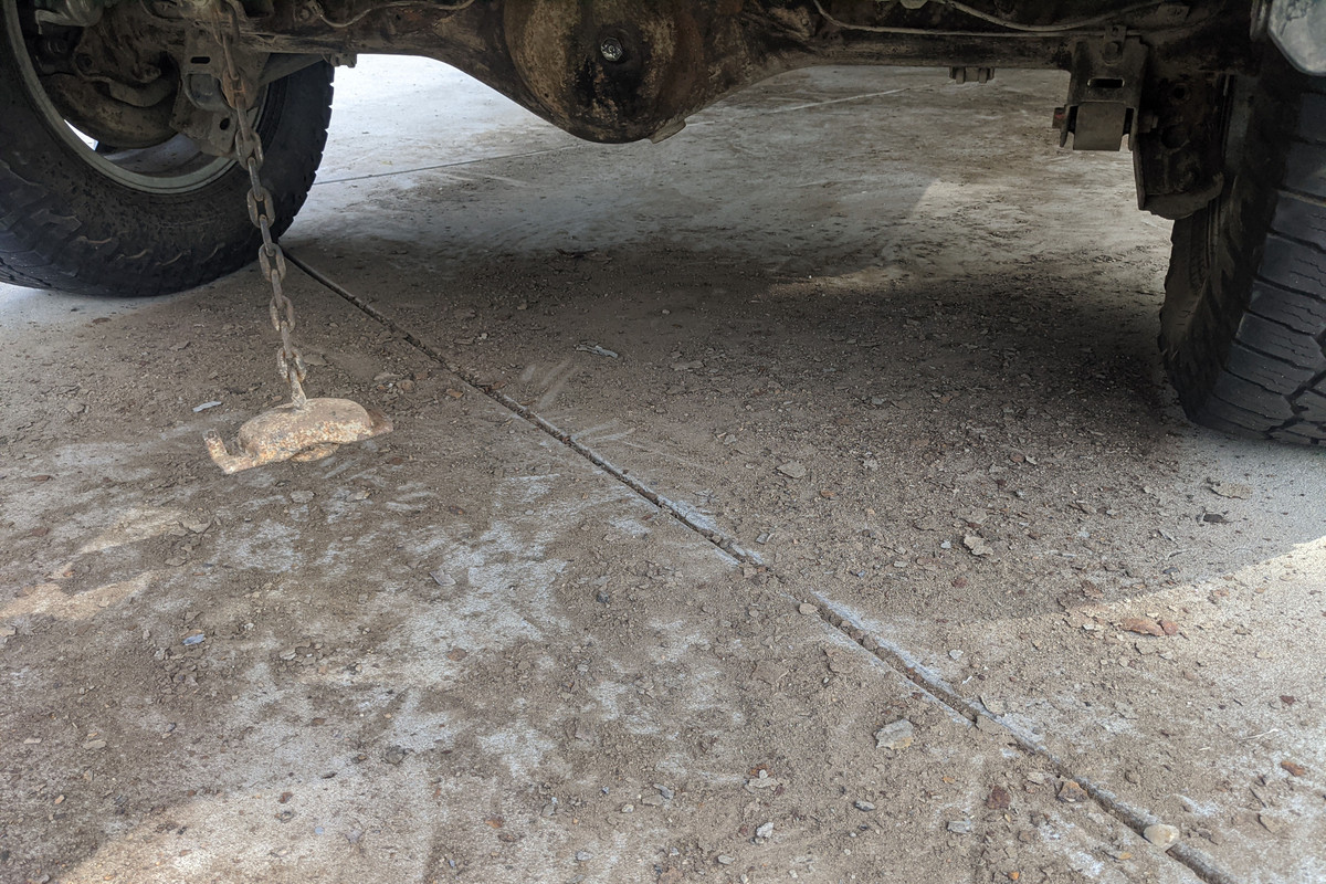

    3rd Attempt
    I think I know what happened. When I was posting this image two years ago, one of the posters mentioned that this is not rust. To him, it looked like the whole undercarriage was covered in something. I came across a video and discovered the stuff that the undercarriage of my 4Runner was covered with.
    https://youtu.be/nXvl9nt57Kg?si=whUEw7Zzq16AccQi
    It turns out that all these years I have been fighting to get layers of rubberized undercoating off of the undercarriage.
    What is interesting is that after the last application of Fluid Film, layers of dried up rubberized undercoating that I was unable to get off before began to peel off. Fluid Film penetrated all the way down to the frame and released them completely.
    While I was researching different undercoating methods, I came across these two videos. Once of them describes how to undercoat with used motor oil, and the other one shows what happened after one year. The second video shows the same process that my frame is going through right now.
    https://www.youtube.com/watch?v=HOQbQwustKo
    https://www.youtube.com/watch?v=WXiZRjuxeJk
    Initially, I wanted to coat Fluid Film over the previous layer. After discovering that new layers of that junk began to come off, I spent the whole morning cleaning out what was remaining of it.
    I didn't bother cleaning off previous layer of Fluid Film that was covered with a layer of dust. I will just coat everything with a fresh layer in a few days.
    Looking much cleaner now.
    Overall, I am happy with Fluid Film. It protected the areas that were clean initially, and penetrated through a layer of rubberized undercoating and released the remainder of it from the frame. Since I do not live in the Rust Belt, snow and salt are not a major concern to me. I decided if I coat undercarriage once every two years, I should keep it in pretty healthy state.
    Sin4R and backpacker like this.
