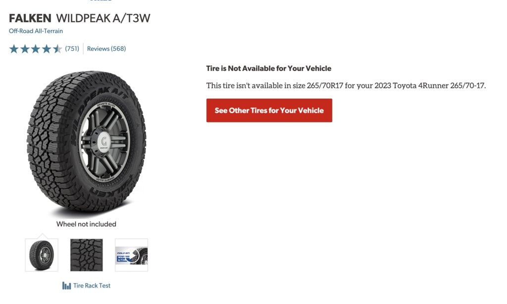

    1. There are multiple posts suggesting tires like Falken Wildpeaks A/T, Nitto Terra Grapplers, and some others, that when I select in tirerack.com, it says these tires do not fit the vehicle ...?

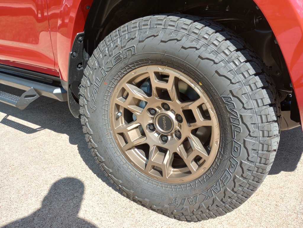

  2. Jul 23, 2025 at 3:38 PM
    3,792
    1) I have Falken's on my OEM wheels. They fit. Maybe the website thought you had a different wheel or something?
    2) SL's will do just fine for towing and daily driving. E rated tires are for people who off road a lot harder. It has a tougher sidewall. But it's also a lot heavier. Example: Falken makes a 265/70 tire in SL and E. The SL is about 12lbs lighter.
    3) My use case is similar to yours. I don't wheel hard and I keep my SloRunner on the pavement a lot because it's my daily commuter, so I run Falken AT's in SL form. I stuck with the OEM size tire too.

    Yeah so it says the Falken Wildpeak A/T4W will fit, but that the A/T3W will not. That doesn't seem right... I was leaning towards the AT3W's since they are lighter and quieter on the highway. I think what this must be saying is they just don't have it in stock, I think they might be discontinued

    ya they’re discontinued in favor of the at4w

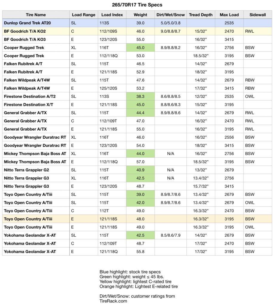

  16. Jul 24, 2025 at 10:20 AM
    2,538
    Sometimes the reason a tire is is claimed to not fit has nothing to do with the size of the tire, but with the load index. BF Goodrich T/A KO2’s are not recommended by BF Goodrich for the 4Runner for that reason. Load index is often ignored when choosing tires, but as you say you’ll be towing near the maximum weight you might keep it in mind.
    For your convenience:
    The table is from this thread.
    Pentangler and kolter45 like this.

    What size tire did you specify on Tire Rack? Your stock tire size shown on the door jamb label is 265/70-17. Picking a different size on Tire Rack "will not fit". Picking a tire with lower than stock "T" speed rating (118 mph) on Tire Rack may also come up negative, even if it will be completely fine for your planned usage.

  20. Jul 25, 2025 at 11:44 AM
    2,538
    I’m not an authority on towing. But while towing a trailer doesn’t put all the trailer’s weight on the car it does put a significant amount onto it. If you look at the sticker on your drivers door jamb it will give you the maximum payload weight including passengers and gear.
    Photo: kmeeg
    It’s not as high a number as you might think. Remember that when we talk about towing we must consider the trailer’s weight and the tongue weight, and the tongue weight counts against the cargo weight. And some times the situation occurs that if you have a vehicle full of people and the cargo area is full of gear and some more stuff on the roof rack plus the added trailer tongue weight you could easily run into a situation where the vehicle is overloaded.
    But that’s all beside the point. If you look at the chart above, at the top is the Dunlop tire came stock on my 4Runner. Directly below it is the BFG T/A K02. The K02 is a very popular tire on 4Runners. But it’s not “recommended” even in the stock size, even with its “C” load range. And the reason is because its specified load index is lower than the stock Dunlops.

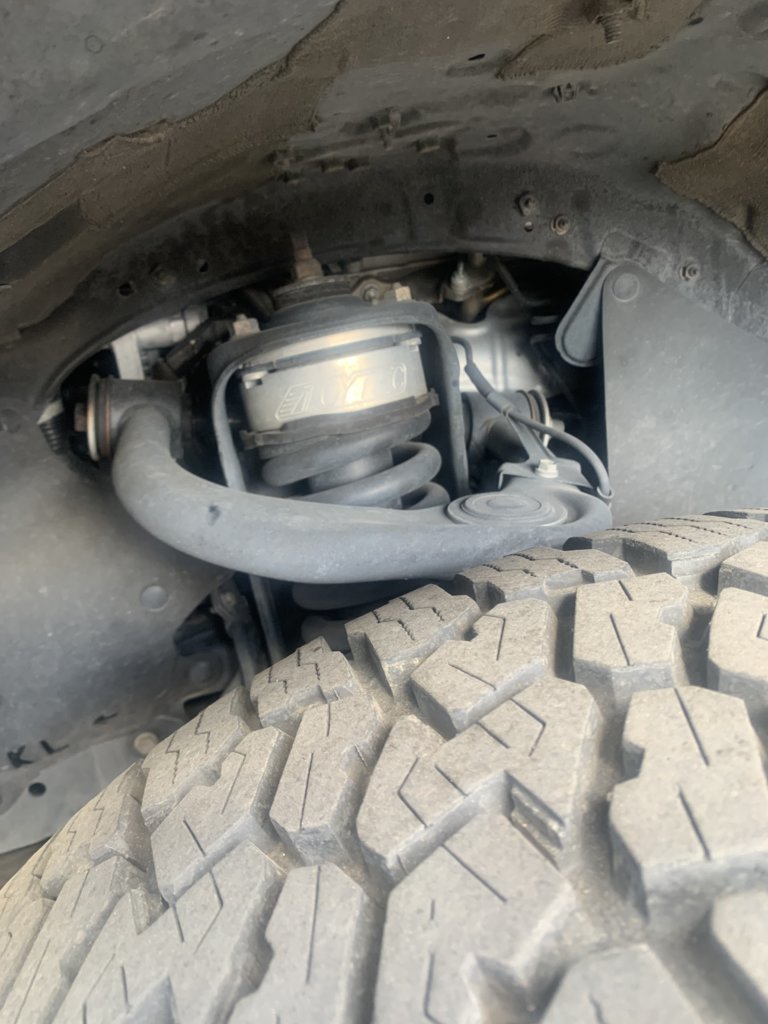

    Changing gears a bit here.. at least on the topic title- I’m pretty sure I want to remove the spacer lift. The dealership almost convinced me to keep it, and I’m a super noob and don’t know much about suspension, lifts, or cars tbh. What I do know is I don’t need it with the stock size tires I’m getting, and that everything I see online indicates they’re not good and could cause issues. Any voices to the contrary? Here’s a picture from the driver side wheel
  23. Jul 26, 2025 at 9:16 AM
    1,315
    :infantry:take the spacer out. No issues there.
    sweetsaltyair, icebear and Saker like this.
  24. Jul 26, 2025 at 9:18 AM
    835
    That’s a TOYTEC 2.5” spacer lift.
    Not a fan of spacers if possible.
    sweetsaltyair likes this.
