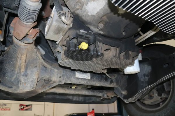

    2,872
    Millions of Ford Super Duty trucks have plastic oil pans. The drain plug is like a radiator petcock. I imagine they have O-rings:
