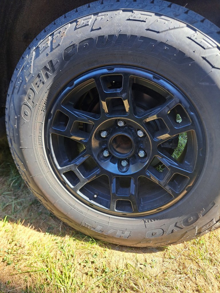

    Those wheels look too shiny to be factory TRD wheels .

    My first thought also- those look too shiny to be the OEM wheels. Unless you have a ceramic coating on them?

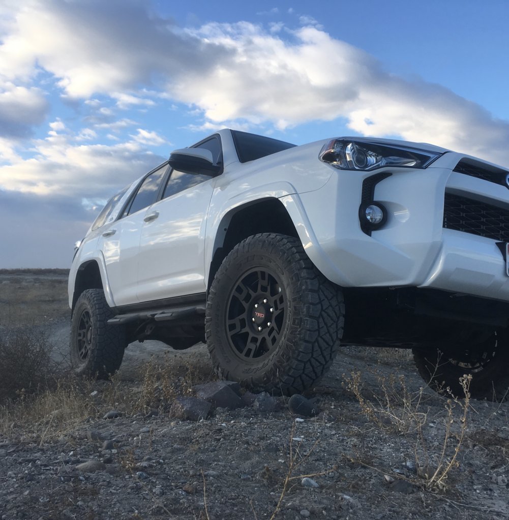

    Here’s a picture of OEM TRD Pro rims.

    That's not the same wheel. That version of OEM wheel is more matte than the OEM version pictured in the OP's first post, assuming the OP's are actually OEM.
  8. Sep 2, 2025 at 12:00 AM
    3,407
    Come to think of it, they did have a gloss version later? If so, then my post would be irrelevant if the gloss version is a different size.

    The wheels could be just about anything. They weere purchased in October of 2023 by the previous owner of the 4R. he got them at a local tire chain, Town Fair Tire, and they were listed as:
    "TRD 4 RUNNER-REMAN"
    size "17x8"
    The 17 x 8 part doesnt even make much sense to me as I cant find a Toyota OEM rim for the 4runner that was that size. According to an employee at Town Fair Tire, the rims were OEM Toyotas that were resurfaced. He may be wrong. I just dont know.
    The tire size on my rims currently as "265/65R17T" Toyo Highlander H/T II
    The 84 mm center cap is just too big. it will not fit. Looking at photos posted in the thread linked by @siblue , I can see the center cap is recessed. The 84 mms are way to big for this. The tabs are bending and they are not going in. Im hoping there are center caps that are less than 84 mm that I can try.

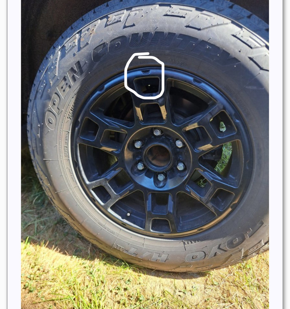

    OEM doesn’t have these divots!
    Or do they?
    Mine doesn’t.

    The 8” is a dead giveaway that they’re not OEM .

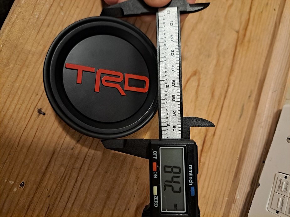

    I measured the TRD OEM center caps, listed as 84 mm. They are indeed.

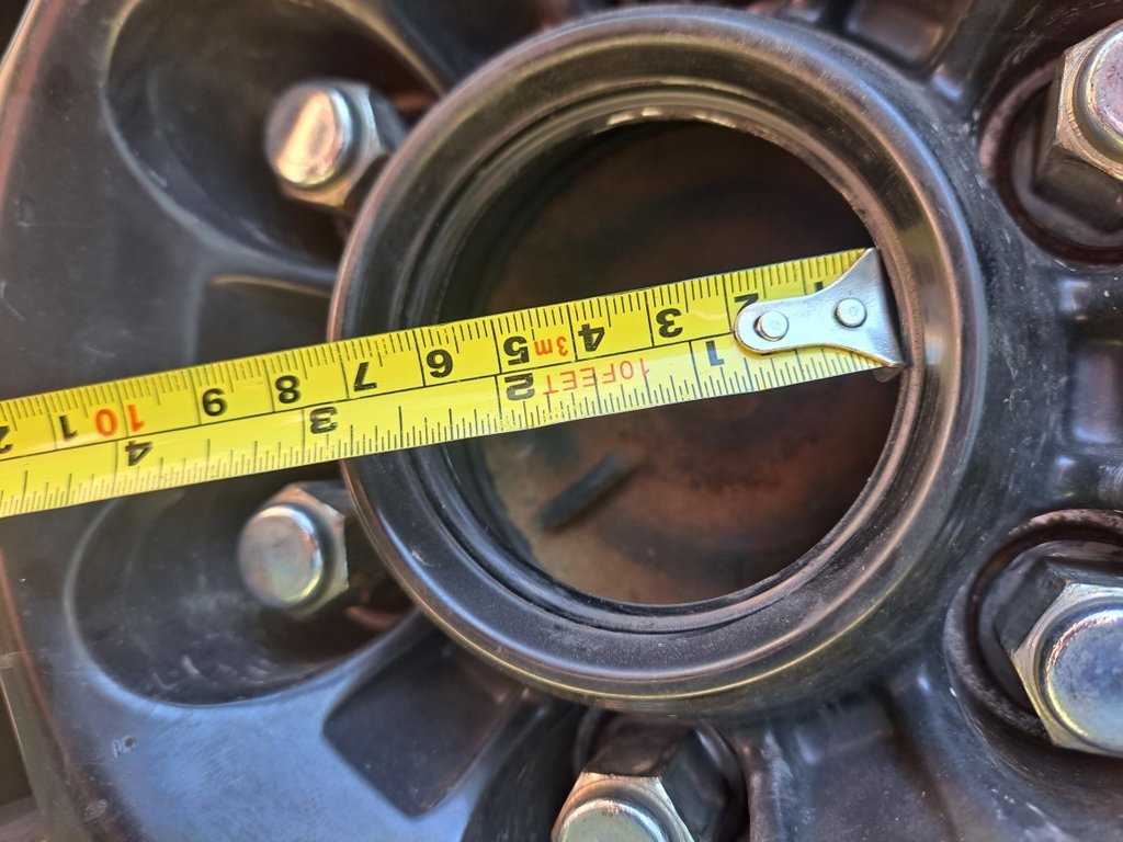

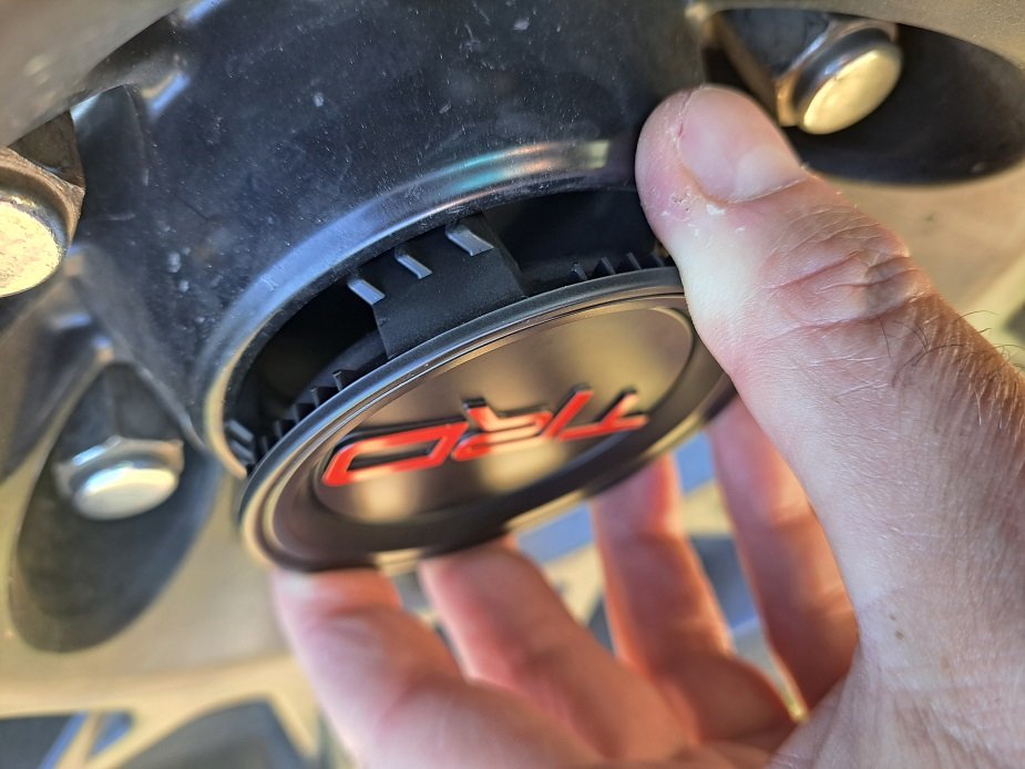

    From these 2 pics, you can see (hopefully) that the 84 mm cap is too big. I think I need a cap around 75 mm. I cant find OEMs of that size.

    These are most likely the wheels you have. They seem to be the only TRD PRO replicas that have a molded concentric circle around the lugs. All others I've seen are smooth formed from spoke to hub center. Try reaching out to Voxx for support. There is no sense in trying any OEM cap on a 100% obvious non OEM wheel.
