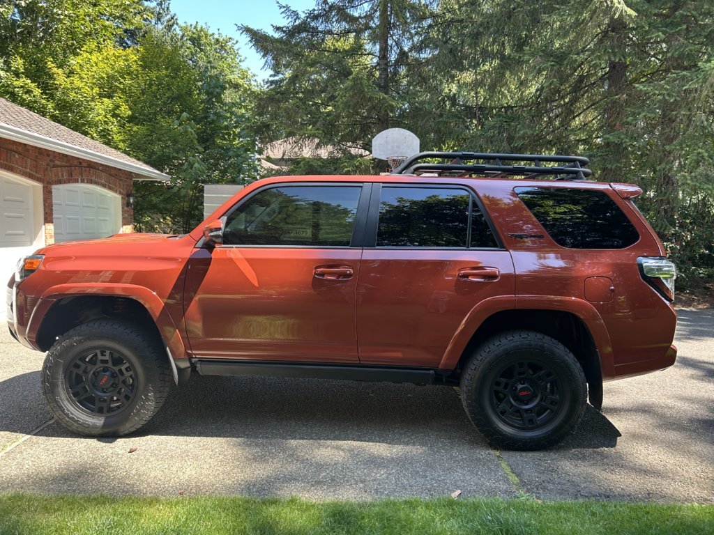

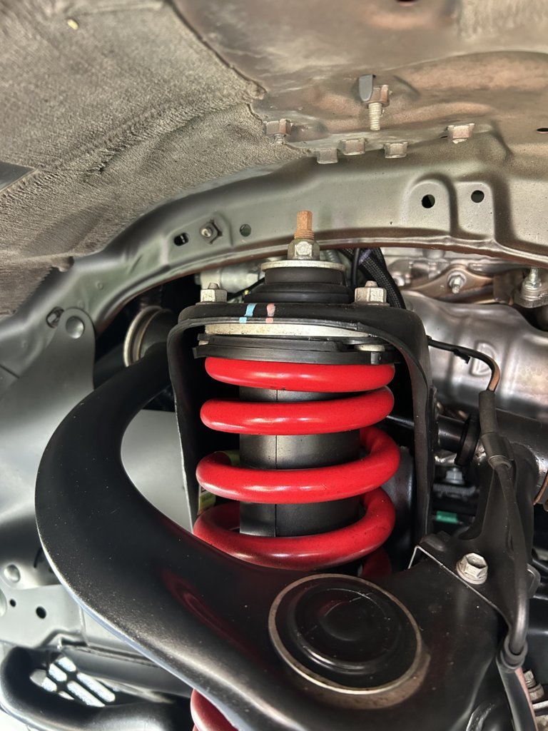

    Hey all! New to the forum. I’m consider purchase of a ‘24 TRD Pro. Looking at the 4Runner, it has a slight reverse rake.
    It doesn’t put me off on buying the vehicle, but want to confirm what’s been done to it (it’s a dealer purchase and they don’t know).

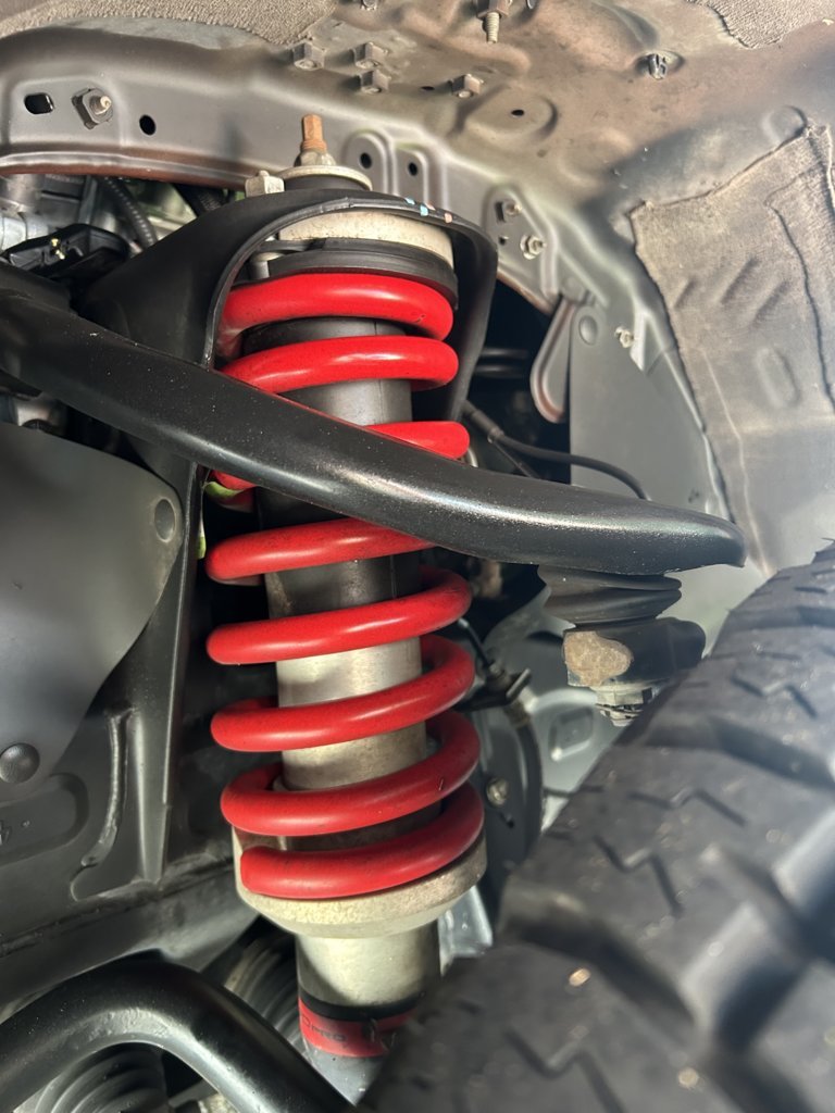

    I took some pictures of the driver front suspension. From this, can someone tell me what’s been modified? It isn’t clear to me there is a spacer?

    Looks like just a spacer stuffed up on top of the coil. Probably could just remove that and get an alignment.

    Welcome. Looks like it has a spacer installed to attempt to level it. How does it look on level ground.

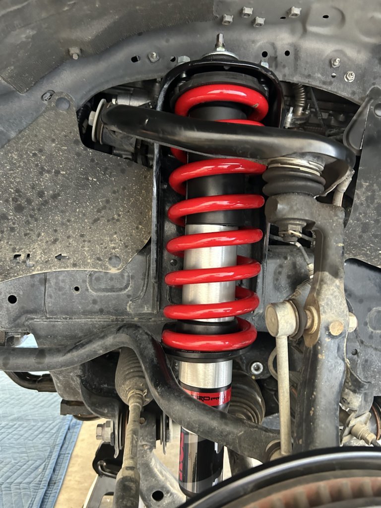

    Factory photo….

    Thanks for all the replies. The drive way is fairly level. It doesn’t look bad (in my opinion) but it is noticeable to me. It’s going to be my wife’s car and she doesn’t notice it so we may just leave it if we buy.
    Should I expect a significant hit to MPG, compared to it being stock?

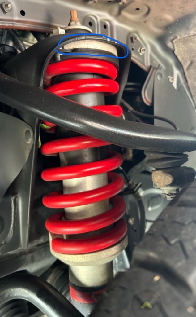

    Mine looks like TxTRD's, yours looks like top and bottom spacers

    Good catch....definitely looks like upper and lower spacers!

    Definitely top & bottom spacers from stock pic to yours. 1st I ever saw bottom spacers:notsure:. Only did top on my 2018 TRD OR Then swapped out for 0.85 lift W/Eibachs. The only draw back was like Op mentioned of towing or load up in aft compartment. Front will float on hiway & when big rig passes have more the 2 fingers on steering wheel. If you don't plan on towing or hiway trips W/Aft loaded nothing wrong W/leveled driving.

    The "double spacer" is made my a few companies. Rather than a single fat top spacer to push the entire coilover down, the smaller top spacer pushes the coilover down, and then the bottom spacer replaces the bottom spring perch increasing preload.
    Definitely a better system than the single top puck. Keeps more OEM like suspension geometry and stiffens it up to limit that annoying nose dive when braking.

    And it sounds like if I just wanted to remove the levelling kit entirely I am going to have to get a new OEM (or similar) bottom spring perch? Not just as easy as removing the spacers, correct?

    Correct, you'd need OEM or similar bottom perches.

    Spring almost looks in a bind from the spacers
