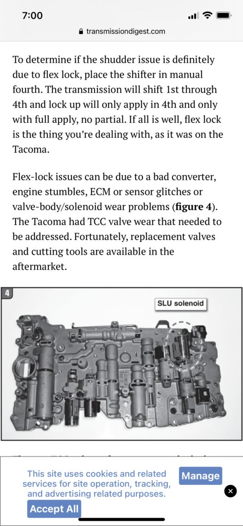

    Read on this forum and the other forum on the topic " shudder/ chatter".
    There are lots of discussions about the Torque Converter.
    My 2017 at 48,000 miles had a failed FlexLock torque converter component in the tranny valve body fail. Long story but repair was accomplished with a new tranny because the torque converter was the symptom NOT the cause. I have the A750 tranny. Toyota's unique FlexLock torque converter design has many problems across many models for many years. There are Toyota Technical Bulletins going back decades. See the attached screen shot from the many I saved.
    I hope your issue is simpler.
