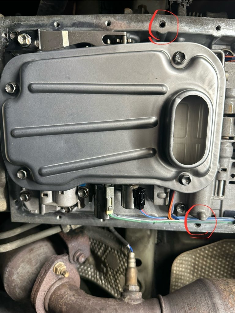

    Tons of DIY's on this I know, but none listed the problem that ruined my day. The Transmission Pan bolts that run along each side of the pan are thru tapped holes. This means that road spray (and salt) gets up on top of these bolts and corrodes them. The fact that you have steel in aluminum only makes it worse. So, of the 6 (12 or so) bolts that run along each side, TWO of them sheared off. These are bolts with a 5 ft-lb torque spec. WTF. Now, a job that should have taken only a few hours is a day and a half. Nothing - NOTHING - is more of a joykill than sheared off bolts. I installed two Timeserts, which I highly recommend over Keensert, Helicoil, etc. BE CAREFUL when removing these screws! It would be wise to hit the tops these with a penetrant the day before for precaution. Since I was also hitting the driveshaft zerks, I put a dab of grease atop each bolt to help keep the water out, and just because I was already there.

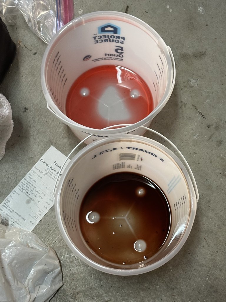

    Another lesson learned was choosing any old Toyota branded ATF off Amazon. OOPS. Pay attention dummy! My drain totaled 7 quarts, so I needed another for my Amazon 6 and bought a quart of ATF WS at the stealership. I got back home and started pumping the fluid in, then took a closer look at the bottles I was using. The Amazon six were the ATF/Power Steering (DexronIII) type. Sh!t! I had already put the WS and two of the Dexrons in. I couldn't live with that, so I drained it, and went back to the stealership today where they stroked me for $20.76/qt for 8 quarts of WS. To add insult to injury, they poked me with a 3% credit card fee. Because they can.

    LOL finesse. Yeah. The first one I sheared was all mine - I took a phone call, got back under the truck and torqued without paying attention. The walls of the garage learned a bunch of new words. Put Aerokroil on all the rest every few hours for the rest of the day and let sit overnight. Was very careful with the rest, and still sheared one. Moved that one back and forth too. Really not in a position to apply heat with the pan on. It was stuck, and that is all there was to it. On the first one I broke, I drilled it 1/8, reversed the bit so the shank was in the hole and hit it with MAPP gas in a way that the only thing being heated was the bit, and it was white hot. Alot of conductive heat into the screw that way, and a few more cycles of Aerokroil and heat. Then busted the extractor in the hole. Yay. And no way to pound it out from the top. Drilled the extractor out. Drilled both sheared bolts out to 7/32. Then I used a carbide burr to make sure the holes ware perfectly centered for the tapping drill. Tapped, installed Timeserts, good to go. I would have broken at least one, and probably two, no matter how much Aerokroil and finesse I applied.

    There was a thick metallic film on all of my magnets - good thing they are there. The weirdest part of the entire change is that my transmission has been overfilled for a long time - as long as I have owned it. With the pan off, and strainer off, I dropped a total of seven quarts which seemed to be a lot from what I have read. I put about 6 3/4 back in at refill. At the temperature to drain to level (110F in my case), I drained TWO quarts, and could have drained more. I sealed as soon the flow became minimal, not to dripping.
