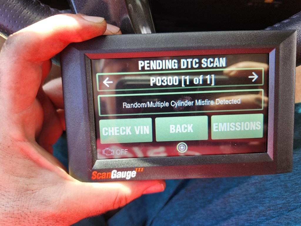

  18. Aug 5, 2025 at 12:00 PM
    bfrank099
    bfrank099 [OP] New Member
    Aug 4, 2025
    #48360
    23
    Brady
    Pennsylvania
    2018 4Runner Premium
    The code is P0300 RANDOM/MULTIPLE CYLINDER MISFIRE DETECTED

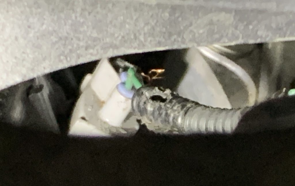

    I'm not a car mechanic. I am an Electronics /PLC tech. I believe that I found the problem, and it directly under the, I'm assuming fuel injection. there are two connectors white..with wires completely chewed off. There is now way I can get to them without removing some big stuff. I am willing to attempt this, but I know nothing about it. I should have the tools, but may need to buy others. Any info on removing the whole intake would be helpful. Or should I take it the garage?

  25. Aug 5, 2025 at 2:20 PM
    3,750
    2019 TRDP w/Kangs brah!
    It's not hard to remove and it sounds like you are more than capable.

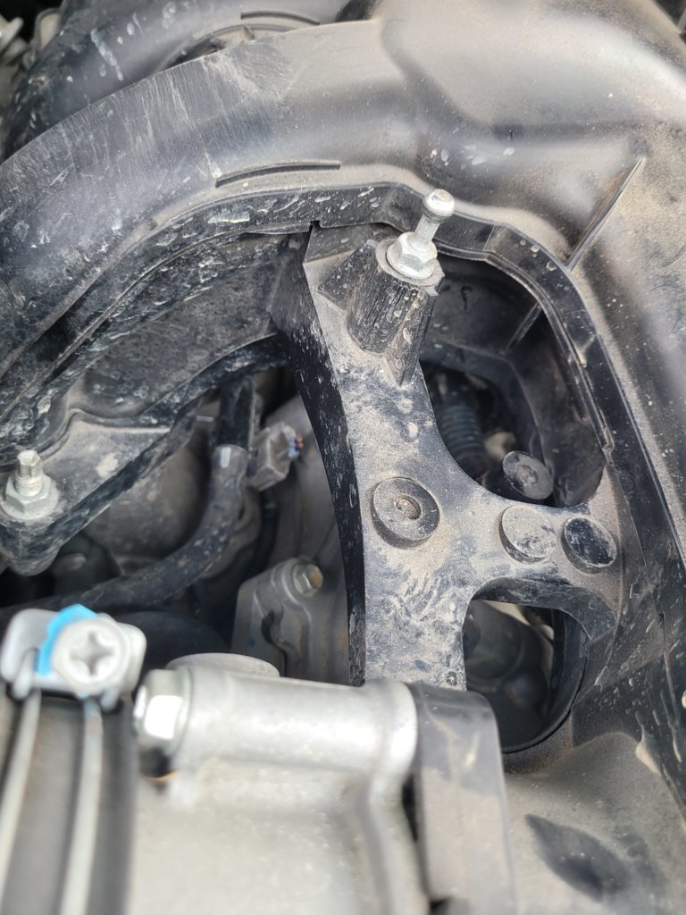

  26. Aug 5, 2025 at 2:24 PM
    1,439
    Brady boss, you are killing us with no sharing pics here. Take some shots so that the folks can help you more. I think what you are describing seems doable if you are mechanically inclined. Heck, I bet if we have forum folks nearby you, they may even come help you out of being nice! Show us and the experts here can say DIY or go to a place.
  27. Aug 5, 2025 at 2:42 PM
    bfrank099
    Aug 4, 2025
    #48360
    23
    Brady
    Pennsylvania
    I have a few pics
    ChessGuy likes this.

  29. Aug 5, 2025 at 2:54 PM
    3,750
    Injector wiring for sure. You can see the copper peaking out at the connector. I would contact your insurance about it. I leave my engine cover off now to keep it from being hospitable for any critters.
