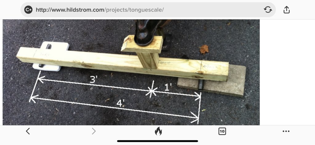

    Good tires on truck & trailer. If the boat has 2 or 3 axles have brakes in top condition on all axles.
    Set your brake controller to engage trailer properly with sufficient power.
    Also boats tend to be streamlined for wind, but can be rear heavy depending on engine and tankage locations. Make sure the boat fits the trailer used. You also need the correct hitch weight.
    Here is a clever DIY bath scale used to directly measure hitch weight. This can help position boat over trailer axles. Guideline is 10-12% of total trailer weight should be on hitch. Math and construction suggestions are on line.
