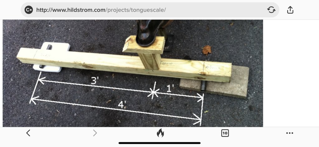

    Are you carefully balancing the weight loafing of the trailer? 11% of total trailer weight (some think more) should be on the hitch.
    Here is a clever DIY to direct measure the hitch weight. The internet provides details of math and construction details.

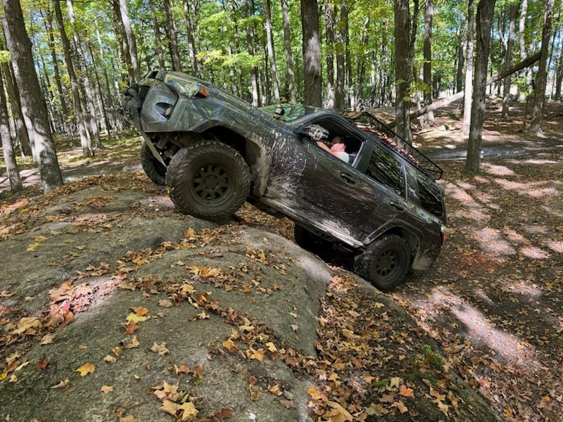

    A bunch of us from here and Tacomaworld will be there this weekend!
    FWIW; I've been through every trail in that park on a 2.5/1 5" lift. Armor is almost more important than lift in all of those rocks.
