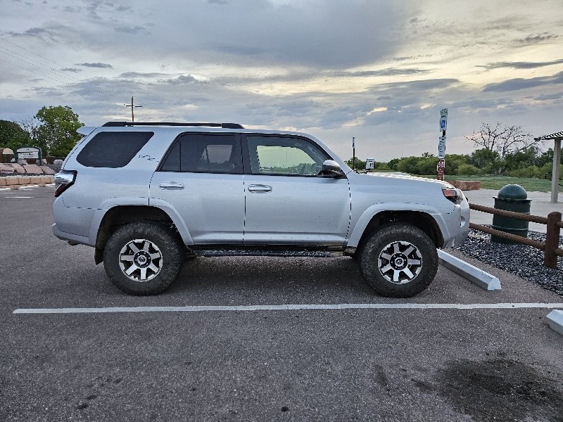

    Hi everyone, I've had a shop install half inch spacers with bilstein 6112s set at 1.9" of lift along with SPC UCAs. I got the idea from the Tinkerer's Adventures's youtube channel as a great way to get as much lift and down travel as possible, but I missed the fact that he only recommends using spacers on stock or standard travel suspension. Now I'm concerned that I'm at risk to bend the shocks or stress the ball joints and CV axles. Has anyone ran or encountered a similar setup, any issues or advice?

    Definitely don’t mix lifts but at least you didn’t add the spacer to a max lifted coilover. So you’re basically at a 2.5 inch lift. Spacer lifts can cause the coilover to bottom out internally before you hit the bump stop and also you are eating up downtravel anytime you lift a double wishbone suspension.

    The shop has agreed to remove the spacer and adjust the coilovers to a 2.5" lift. My initial plan was to only lift 1.9" to preserve down travel and lift the rear 1" but the rear's been lifted 2" and I really like the new stance. Plus they're not charging me to adjust the lift, doesn't feel right to ask them to change the rear springs too.
