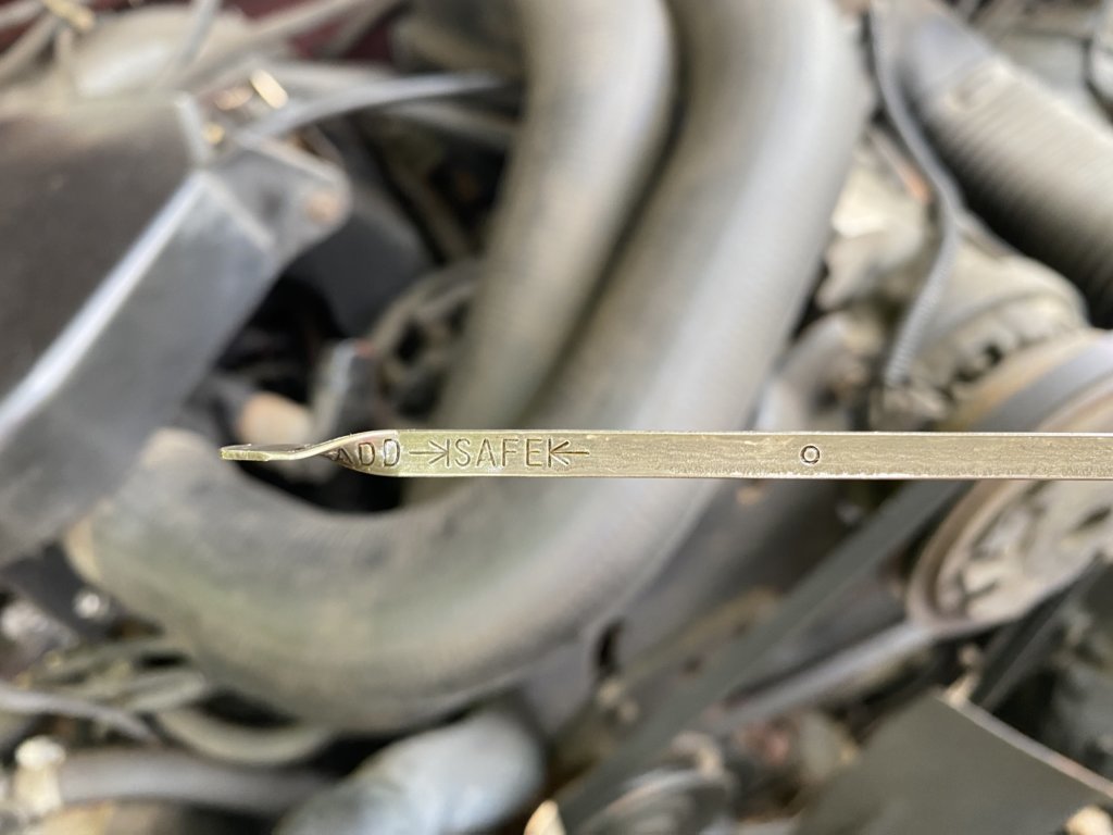

    I always put the exact amount it calls for with oil filter change and call it a day. Just checked the Ford its showing over. But its creeping. The 4R always shows low on the dipstick but I dont add any know its good.IMG_1657.jpg
