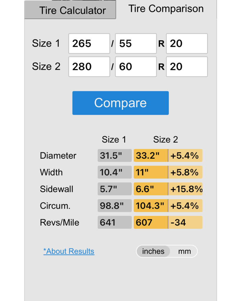

    I know 275/60/20 fit, that’s the only size I have confirmed. I’m going for the widest stance. See image… and thank you.

    Use this, plug in what you know will fit, and then play with the numbers until you get a height you like and then start looking for tires in that size.
    285/55-20 and 285/60-20 would likely be your play if you are trying to go taller without going a lot wider.
