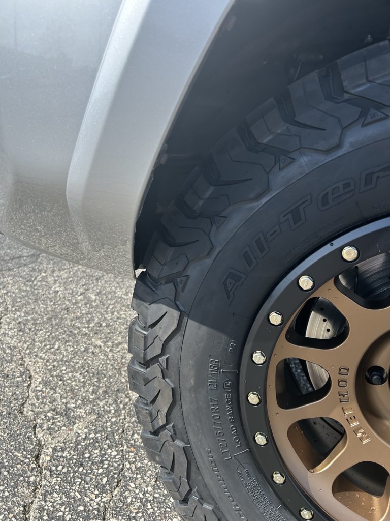

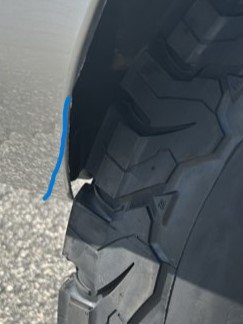

    Recently put new tires on my 2020 4 runner :BF Goodrich All-Terrain T/A KO2 Tire (32" - 275/70R17) and a rough country 2 inch lift. Took it in to get a tire alignment & I immediately notice the front tire was rubbing on the bumper when backing out. I didn't hear any rub from the rear - how can I fix this? Should I go 3 inch lift? I would like to prevent viper cut and I really want to keep my new tires. Pictures and link for reference. Please help!Image.jpg 222.jpg

    Just trim that little corner like the TRD Pro gets done.

    A utility knife and a fender liner adjustment should be all it takes.

    Time to go to school. Here ya go:
    https://www.4runners.com/threads/tire-clearance-school.44640/#post-719786

    Also too little offset on those Method wheels. Might not rub with the oem wheels.

    Not that this will be any help, but this is exactly why I hate the 275/70 tire size. Big enough to rub, not big enough to notice the difference between these and the OEM size.

    Absolutely no rubbing off Roeding and I put it to the test not overly abusive test but hard turns left and right up and over berms absolutely no rubbing. I hope this helps. lastly, I use the Dremel to make the cut.

    @wyldrr89 did you happen to get new wheels at the same time as those tires?

    yes I did, they were just mounted on & tire alignment was done at the dealership

    Crazy part about it, went with the 275 because I was trying to avoid trimming or viper cut. And if I have to have to trim should of just went with the bigger size

    Also just found out I have 1 inch clearance on the right side with no rub... how does that even make sense at this point?

    Likely caster is playing a part there.
    Just trim a little on both sides. All good.
