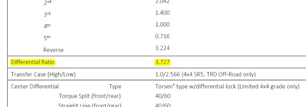

    Just an FYI. Your 4runner came with 3.73 gears from factory. Every 4runner model comes with the same gear ratio.

    Well according to the company that specializes in gearing they checked the VIN to verify what gearing it had installed. I do not know for certain, there are numerous sites that say only 3:73 there are other sites that say that a towing package or the off-road model with lockers come with different gearing. I really don’t care. The company that did the work is highly rated and has been around for decades and came recommended highly by personal friends who know more about vehicles than I ever will. I find it hard to believe they would stay in business for a long time while lying to customers. No insult but I will believe my friend’s recommendation and that company over someone I don’t know at all who is on a forum site. In the end it doesn’t matter and your post is meaningless to the discussion. But have a blessed day.

    3,068
    Here ya go, ejaculated straight from the horse: https://pressroom.toyota.com/2018-4runner-product-info/ But feel free to believe whatever.
