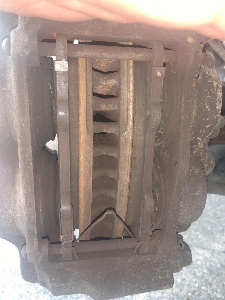

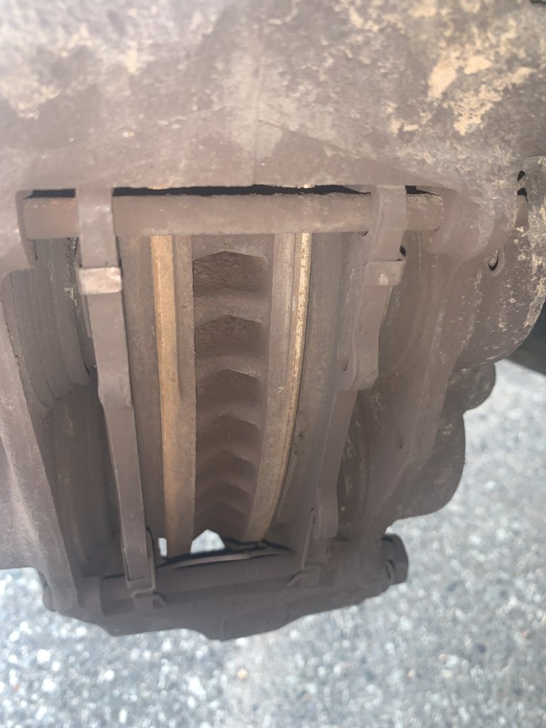

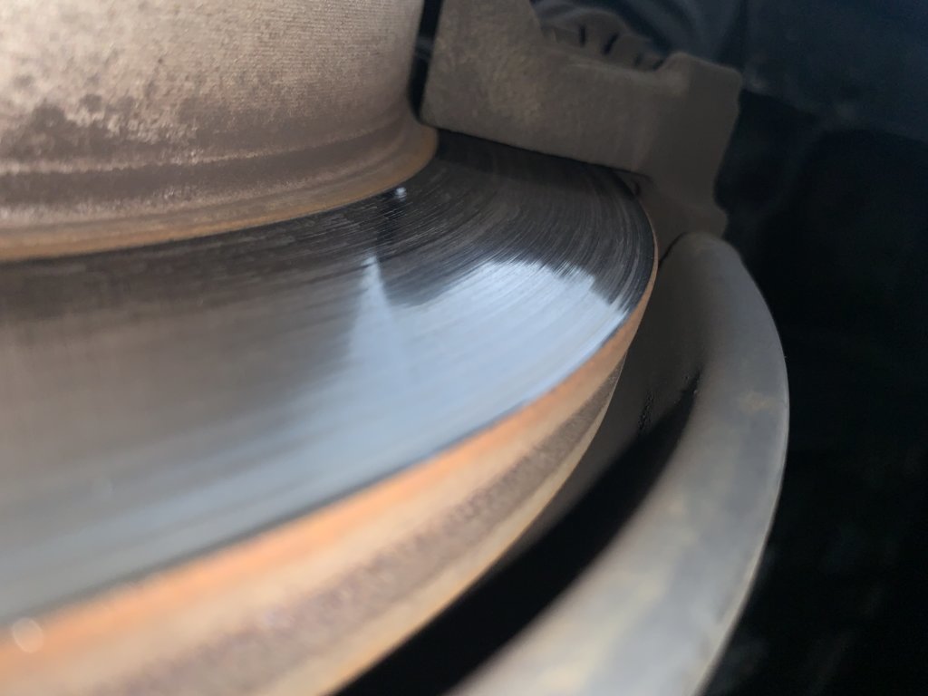

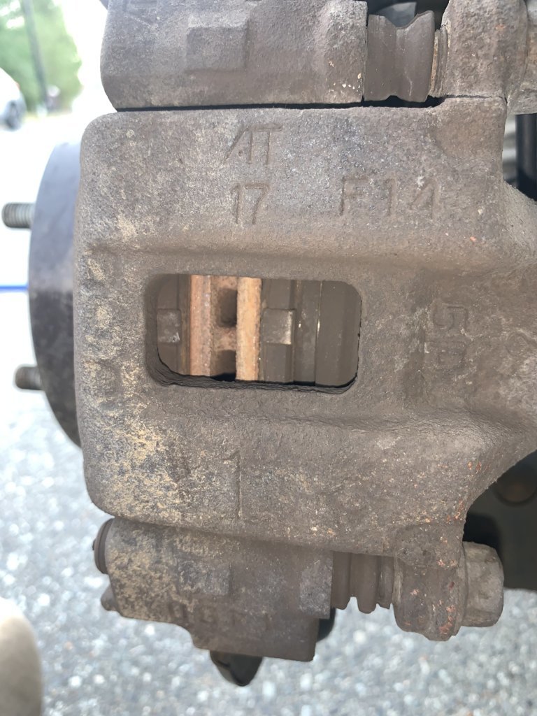

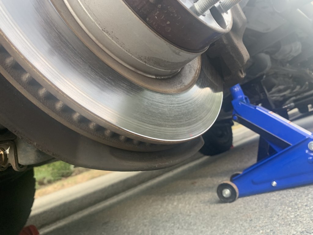

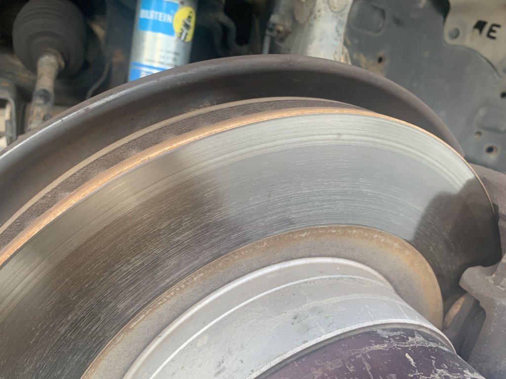

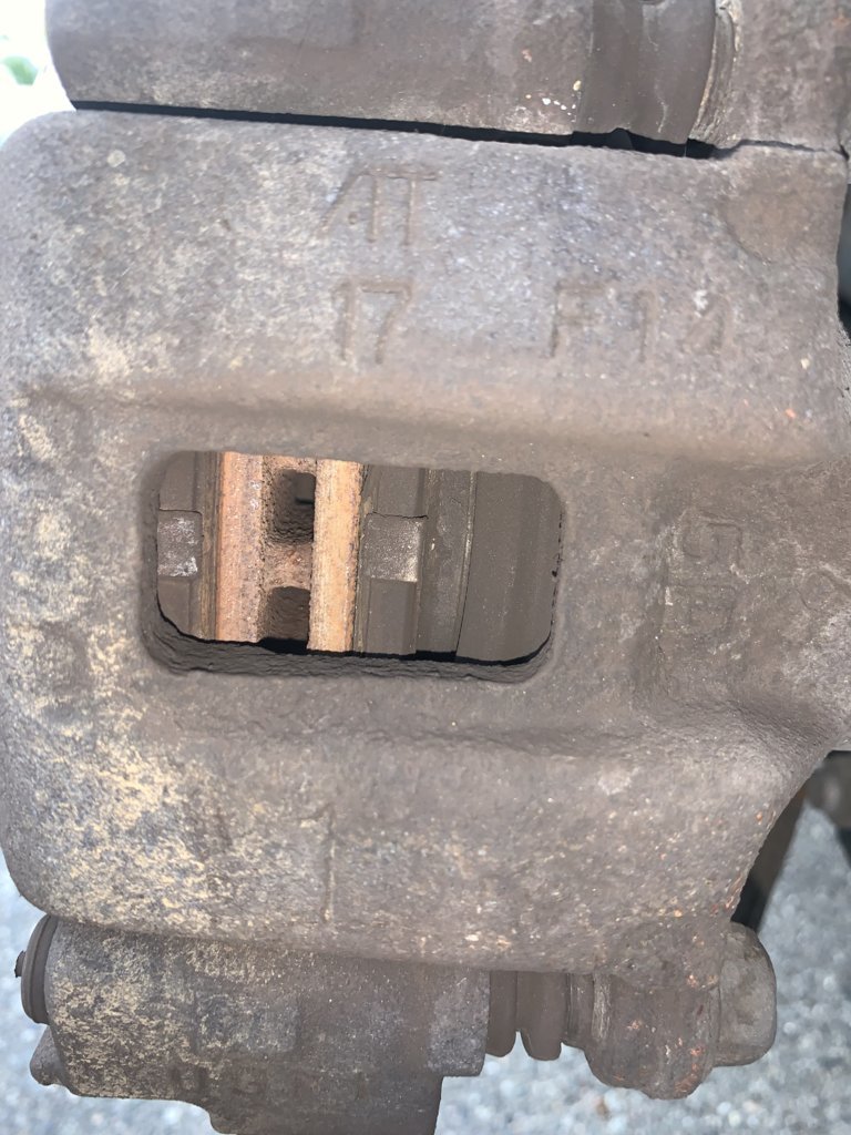

    Brakes making contact noise even after wheels off for brake cleaner. No vibration really, rotors I don’t think are warped at all. No towing. Almost all very close proximity, high traffic city driving. Pads aren’t OE. Maybe 60k on them and rotors (replaced at same time)
    Driver front
    Driver rear

    Looks at the little noise maker on the pad. Going to assume its touching.

    The fronts have plenty of life left. The rears are worn out. They will be metal on metal very soon.

    The fronts have wear uneven at bottom.
    I would change all pads F & R. If you can get the exact same pads (did you save old pads in box for the pads on now?). I usually do not turn rotors unless I am changing pad brands. If exact same new pads are available I would clean up the calipers really well. I always open the bleeders when pushing pistons back into caliper.
    Prior to starting pad replacement I suction out all old brake fluid in reservoir, refill 1/2 with new and then suction again. Then add 3/4 full reservoir with new fluid.
    Lube the caliper pins properly & Lube the anti noise shims where the pistons push on pads. When done fill brake reservoir.
    Then bed-in the pads with driving/braking process well described on internet.
    Brakes are cheap and our runners use them in the traction control systems too.

    Replace those rears.

    The rears are shot. Fronts are close...can maybe another year or so before they need to be replaced. If were my car, I'd would do brakes all around; but at the very least pull the front pads and clean them and the hardware.. those pad pins are pretty cruddy.

    A little time left on the fronts, but the rears are toast, change 'em all.
