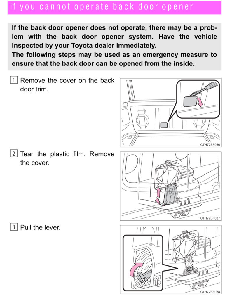

    Hey guys, I have a problem.
    From inside the truck:
    - I cannot open/close the tailgate window
    - The rear wiper/washer doesn't work
    From the outside (with my key):
    - I cannot open the tailgate
    - I CAN open/close the tailgate window
    Looked in the fusebox under the hood and can't find anything related to rear wipers/tailgate. Any suggestions?

    There’s the fuse box under the hood, and there’s a second fuse box under the dash in the drivers footwell, near the hood release. I have a 2010 wiring diagram, which is probably not 100% accurate for your 2019 Pro, but on that diagram there are multiple fuses involved, as well as a module called the Multiplex Network Door ECU. So when you’re poking around checking those fuses, also check any fuse that begins with IG or ECU.

    Awesome link Hokie, I'll check it out and report back.
