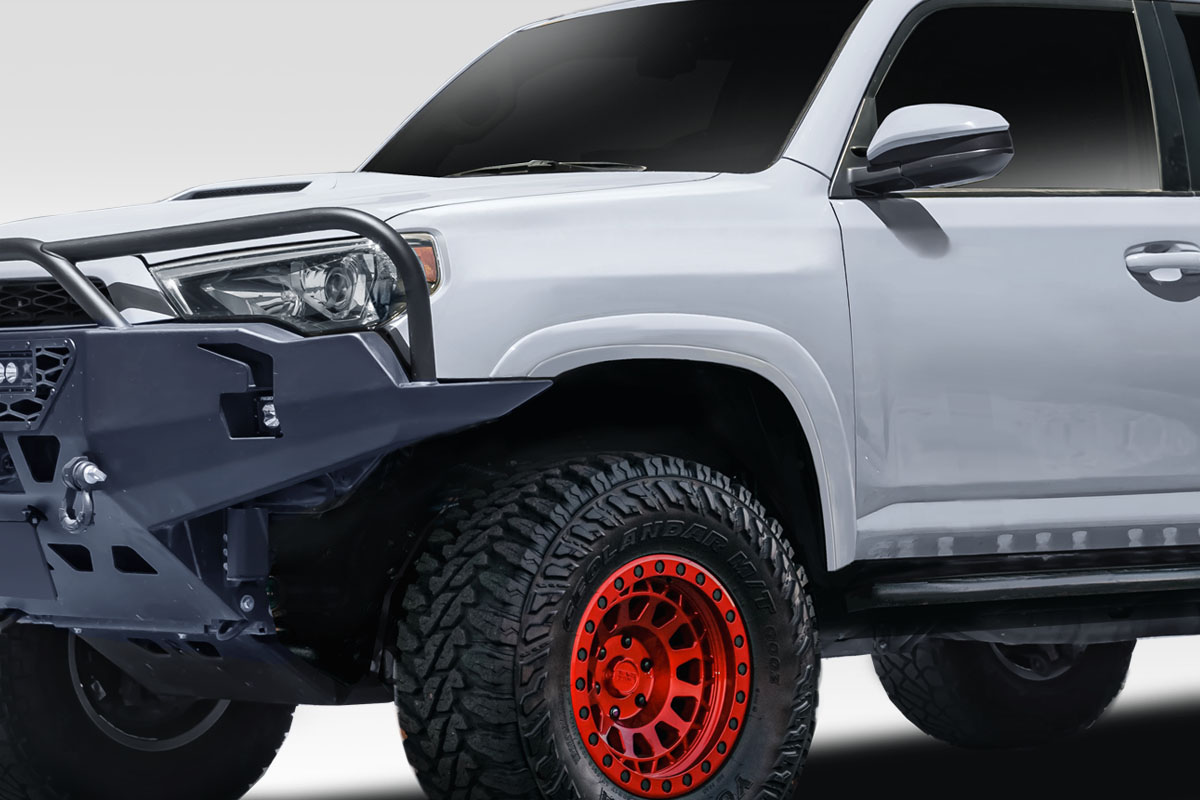

    Could get something more Moab-appropriate :boink:

    I am not saying no to your suggestion because id really like that BUT i dont control the checkbook. I really like that bumper.
