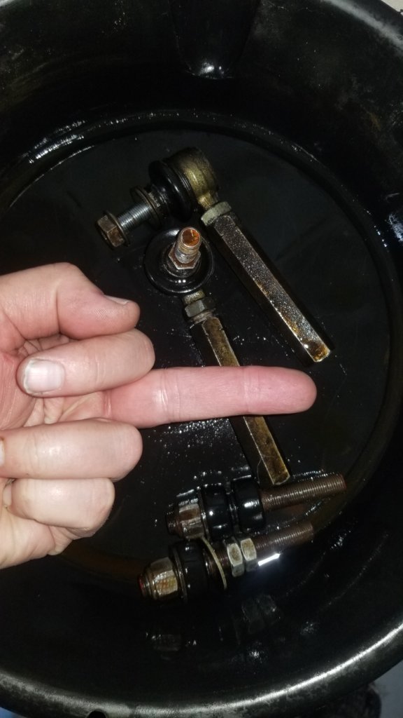

    Yeah, I’ve seen plenty of complaints about these screw-out adjustable links. Sealed ball joints or not, it’s the screw adjustments that fall apart with time, or quickly if you live in the salt belt.

    In my case, i'm guessing miss matching material and a bit of salt had them stuck really good.

    Had same ones here in S. Texas. No road salt and relatively mild off-roading. Rear set of the screw out links lasted 1.5 years then...BAM fell apart. They look cool and separate you from your wallet but that's it.
    Replaced all 4 with stock and there is no difference. Snake oil is what I would call the adjustable ones.

    TBH I put "extended sway bar links" into the google machine and that is what came up. I'm glad I did, because now I'll never put them on my rig. Thanks for the feedback. I was hoping to see a Suspension Maxx extended sway bar link like what I have on my 1st gen Tundra. I'm surprised there's not one for 5th gen 4R.
